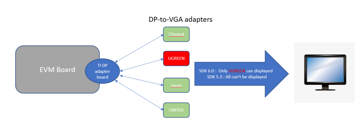

Hi:
We found the DP problem in using EVM boards.
Test environment:
Hardware: AM654X EVM PROCESSOR BOARD (REV 1.0)
                 TI DP Board( DisplayPort Adapter PROCOO77 REV E1 TC358867)
                 Monitor:HP-E242 ,HP Compaq LA1951gl
                 DP-to-VGA adapter's Manufacturer: Choseal,  UGREEN, biaze, ce-link
Software: Processor SDK Linux 06_00_00_07  Processor SDK Linux 05_03_00_07
Expected results:
First In the U-boot  Setting environment variables  :set name_overlays k3-am654-evm-tc358876.dtbo
Using SDK6.0, the EVM board uses the above DP-to-VGA converters to connect the monitor display picture.
Actual results:
Only the UGREEN content DP-to-VGA display has pictures, and ‘Choseal  ,  ce-link,  biaze’  has no pictures (these are sure to be all right, verified by PC).
Note: Use our Own board to verify:
1. Using  SDK5.3 U-boot  can all  display pictures (Choseal,  UGREEN, ce-link, biaze).
2. Using SDK6.0 U-boot (Keeping the Kernel Mirror Consistent), only UGREEN can display the pictures, which is consistent with the results of the EVM board.
3. So I suspect that it's related to u-boot   and I tried to use SDK5.3 on the EVM board to see the phenomenon, but it did not  display the picture use all adapters.

    I am wondering if you have tested your custom board using a displayport cable directly instead of going through an adapter.
    Krunal
    I test it  use DP Direct Connection:
    SDK 5.3:   EVM (Fail)         My own custom board  (OK)
    SDK 6.0:   EVM (OK)         My own custom board  (OK)

    On PSDK5.3, we were using the mcu_i2c0 bus in the k3-am654-evm-tc358876.dtbo file. However, due to hardware issues, we changed to the main_i2c1 bus in PSDK6.0. In order to have PSDK5.3 work on TI EVM, please make the following changes in the k3-am654-evm-tc358876.dtso file:
    diff --git a/arch/arm64/boot/dts/ti/k3-am654-evm-tc358876.dtso b/arch/arm64/boot/dts/ti/k3-am654-evm-tc358876.dtso
    index c9873fd744b..b695164c4d9 100644
    --- a/arch/arm64/boot/dts/ti/k3-am654-evm-tc358876.dtso
    +++ b/arch/arm64/boot/dts/ti/k3-am654-evm-tc358876.dtso
    @@ -61,7 +61,7 @@
    -&mcu_i2c0 {
    +&main_i2c1 {
            #address-cells = <1>;
            #size-cells = <0>;
    @@ -74,6 +74,8 @@
                    clock-names = "ref";
                    clocks = <&dp_refclk>;
    +               toshiba,hpd-pin = <0>;
                    ports {
                            #size-cells = <0>;
    With regards to the adapter issues, are the four adapters working or not working on PSDK5.3?
