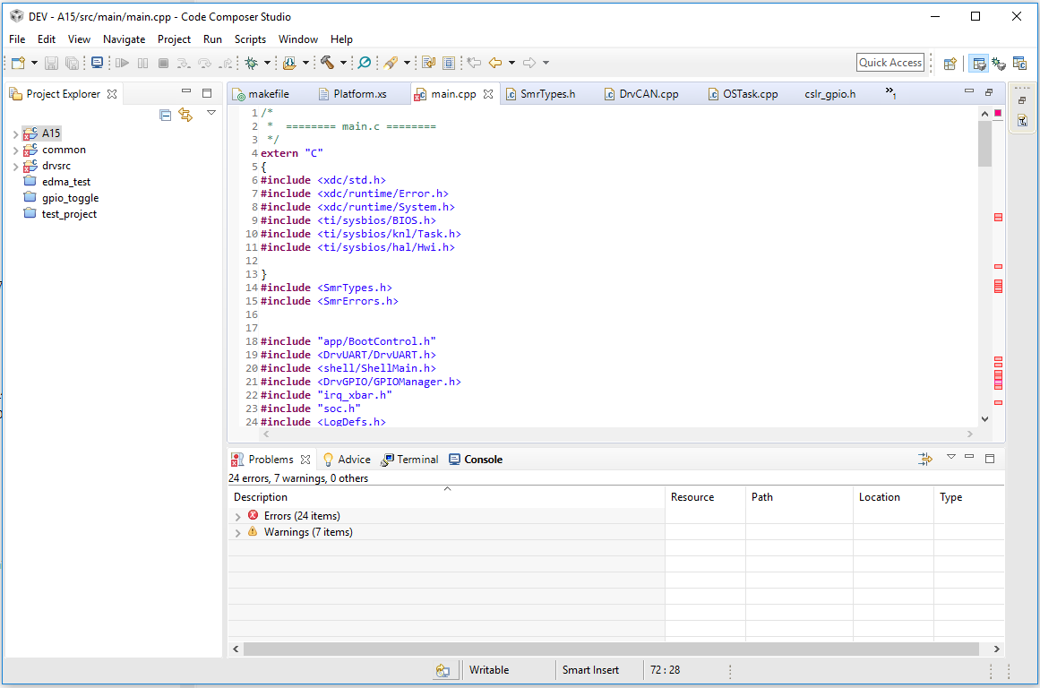

I followed Slide 14 which says:
TDA2x EVM Debug Setup
14
•In CCS, setup TDA2x target configuration with Spectrum Digital XDS560v2 STM USB Emulator connection
–Go to File New Target Configuration File
–Type file name as XDS560v2_VAYUEVM and click Finish
–Now select Connection as “Spectrum Digital XDS560V2 STM USB Emulator”
–Type ADAS-S28 in the Device field; device names will be filtered; select/check ADAS-S28
–Click on Target Configuration from Advanced Setup (RHS)
–Check Bypass for the unused CPUs to save time when launching.
–Select View->Target Configurations to see a list of all configuration files.
–Select the one you just created (as XDS560v2_VAYUEVM.ccxml) under User Defined.
–Launch the debug session by selecting the Launch Selected Configuration in the context menu.
In Step 2 I clicked Finish as it says, the window closed.
But step 3 where is connection ?
I cannot find it.
