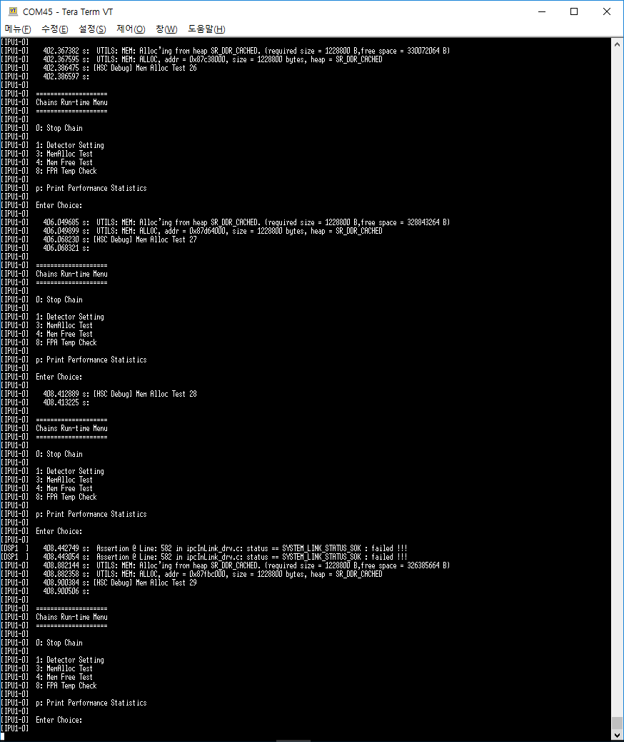

My customer faced system hang when they tried to allocate additional memory dynamically on the heap of SR_DDR_CACHED region.
They used 'Util_memAlloc()' function in the chains_XXX_SetMemAllocInfo() function of usecase to allocate memory dynamically on the heap of SR_DDR_CACHED region, but faced system hang.
Could you please check below log and let me know some comments?

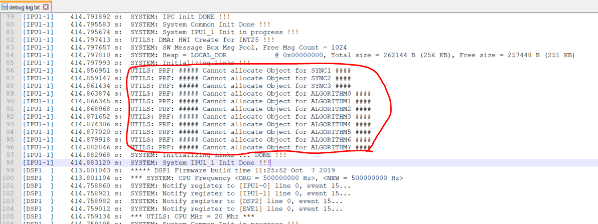

[IPU1-1]    414.856951 s:  UTILS: PRF: ##### Cannot allocate Object for SYNC1 ####
[IPU1-1]    414.859147 s:  UTILS: PRF: ##### Cannot allocate Object for SYNC2 ####
[IPU1-1]    414.861434 s:  UTILS: PRF: ##### Cannot allocate Object for SYNC3 ####
[IPU1-1]    414.863874 s:  UTILS: PRF: ##### Cannot allocate Object for ALGORITHM0 ####
[IPU1-1]    414.866345 s:  UTILS: PRF: ##### Cannot allocate Object for ALGORITHM1 ####
[IPU1-1]    414.868968 s:  UTILS: PRF: ##### Cannot allocate Object for ALGORITHM2 ####
[IPU1-1]    414.871652 s:  UTILS: PRF: ##### Cannot allocate Object for ALGORITHM3 ####
[IPU1-1]    414.874306 s:  UTILS: PRF: ##### Cannot allocate Object for ALGORITHM4 ####
[IPU1-1]    414.877020 s:  UTILS: PRF: ##### Cannot allocate Object for ALGORITHM5 ####
[IPU1-1]    414.879918 s:  UTILS: PRF: ##### Cannot allocate Object for ALGORITHM6 ####
[IPU1-1]    414.882846 s:  UTILS: PRF: ##### Cannot allocate Object for ALGORITHM7 ####
[IPU1-1]    414.882968 s:  SYSTEM: Initializing Links ... DONE !!!

    It seems there is some failure for Resizer and dss link. Please check the parameters.
    It does not look like memory issue as there is still around 300MB memory free..
    Brijesh
  • Hi Brijesh,
    My customer checked Resizer and dss link parameters, but could not find any strange things.
    They tried to test it again and they allocated additional memory after boot, and found below error message.
    Assertion @ Line: 582 in ipcInLink_drv.c: status == SYSTEM_LINK_STATUS_SOK : failed !!!
    Do you still think there were some issues in the Resizer and dss link?

    Could you please let me know which part tell you there is some failure for Resizer and dss link in the previous log I shared before?
    I found below errors from the previous log, and can you guess why below errors were occurred?

    My customer did more test by adding allocating memory blocks in the usecase and they created memory blocks incrementally(create block1, block2, ...)
    They found the error occurred when created memory block reached to some memory region.
    When they connected JTAG and CCS, they found there was no response while creating memory block in the shared memory regions. When they stop in the CCS, they found there is infinite looping in the mem_alloc() function.
    So, they believe they failed to allocate more frame buffers in the shared memory region. Could you please check below captured log and let me know your idea on this.
    I believe you can find the error was occurred at around 0x8800 0000 in below captured logs.

    This issue was resolved. It seemed there was an issue in their DDR column settings and this issue was gone after correcting DDR column settings.
