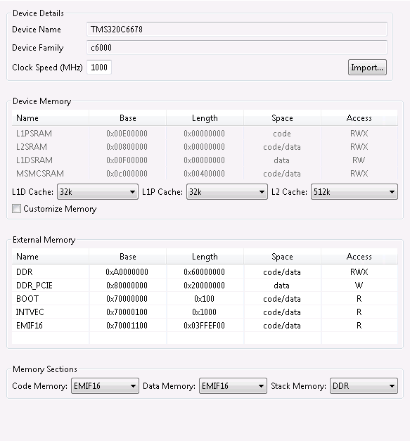

I have a 128-MB NOR flash connected to the DSP through the EMIF16 interface (in the address range 0x7000000:0x77FFFFFF), and I want to convert my application.out file to a bootable *.bin file so that the DSP autonomously boots with that application image flashed onto NOR.

- Given the boot pins are set to I2C master boot with slave address 0x51, how does the IBL know where the application image is located? I mean, in this example, the IBL transfers control to the application binary located in the NOR flash, but how does it know the application is in NOR flash and in which address range the application is flashed?
- This BIN image is generated using the tools hex6x, b2ccs, and ccs2bin on the built OUT file, isn't it? So how should I populate the RMD file when using hex6x? Is the RMD example in https://e2e.ti.com/support/processors/f/791/t/367102 still valid here?
