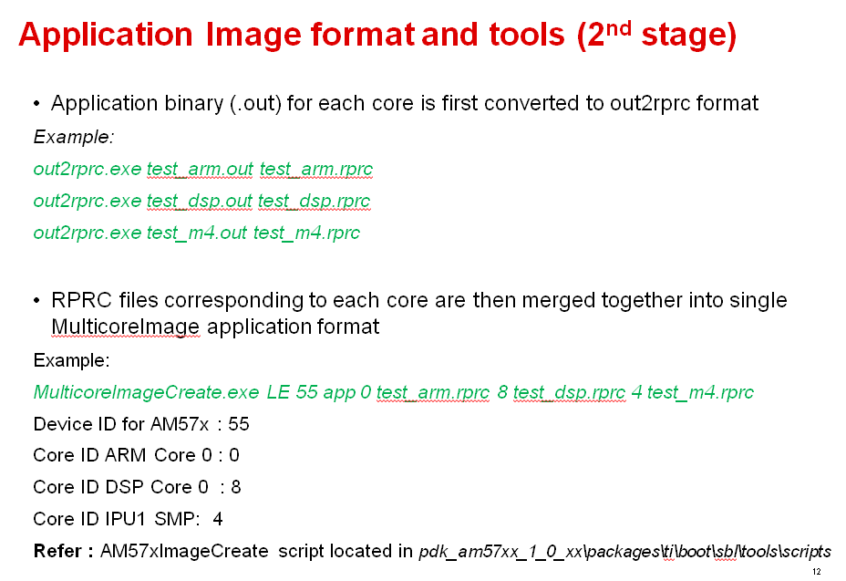

I am using AM5718,CCS Version 8.2 ,SDK RTOS v 5.02. I want to boot my dsp core from host arm core via shared memory.kindly share the documents regarding this...

Muhammad,
The recommendation to boot the DSP core in a system which has ARM as the boot master is to use RTOS Secondary bootloader (SBL) and create a multi-core application image. The SBL can be single location where all the SOC initialization can be done (pinmux, clock, DDR and slave core wakeup). Make sure that the DSP application does not overwrite the initialization that may be required on the ARM.
The image generation and formats are explained in the link above, but for clarity you can refer the graphic here to understand the steps:
If the ARM and DSP need to communicate, you can use IPC_start and IPC_attach APIs which is used for synchronization and will wait for the cores to come up and create IPC channel for the cores to communicate. Memory partitioning between ARM and DSP at application level is application integrator responsibility the SBL will just load the application and start the application on the cores.

I need to know about the format of hex code file that loaded from flash to internal memory or DDR while booting from flash.I want to directly load that file to the bootable area of internal memory or DDR without merging all core file to a single one.
I am not sure that I understand the question completely. All DSP and ARM binaries (.out, .xe66, .xea15fg) are in standard ELF binary format used by compilers
http://software-dl.ti.com/ccs/esd/documents/sdto_cgt_A-Brief-History-of-TI-Object-File-Formats.html
For the purpose of the bootloader to load them, we use the out2rprc format which is merged into Multicore image to load and boot all cores on the SOC, the out2rprc and MulticoreImage format is described here:
Hope this helps. If not, please clarify what you are looking for so we can address your issue.
