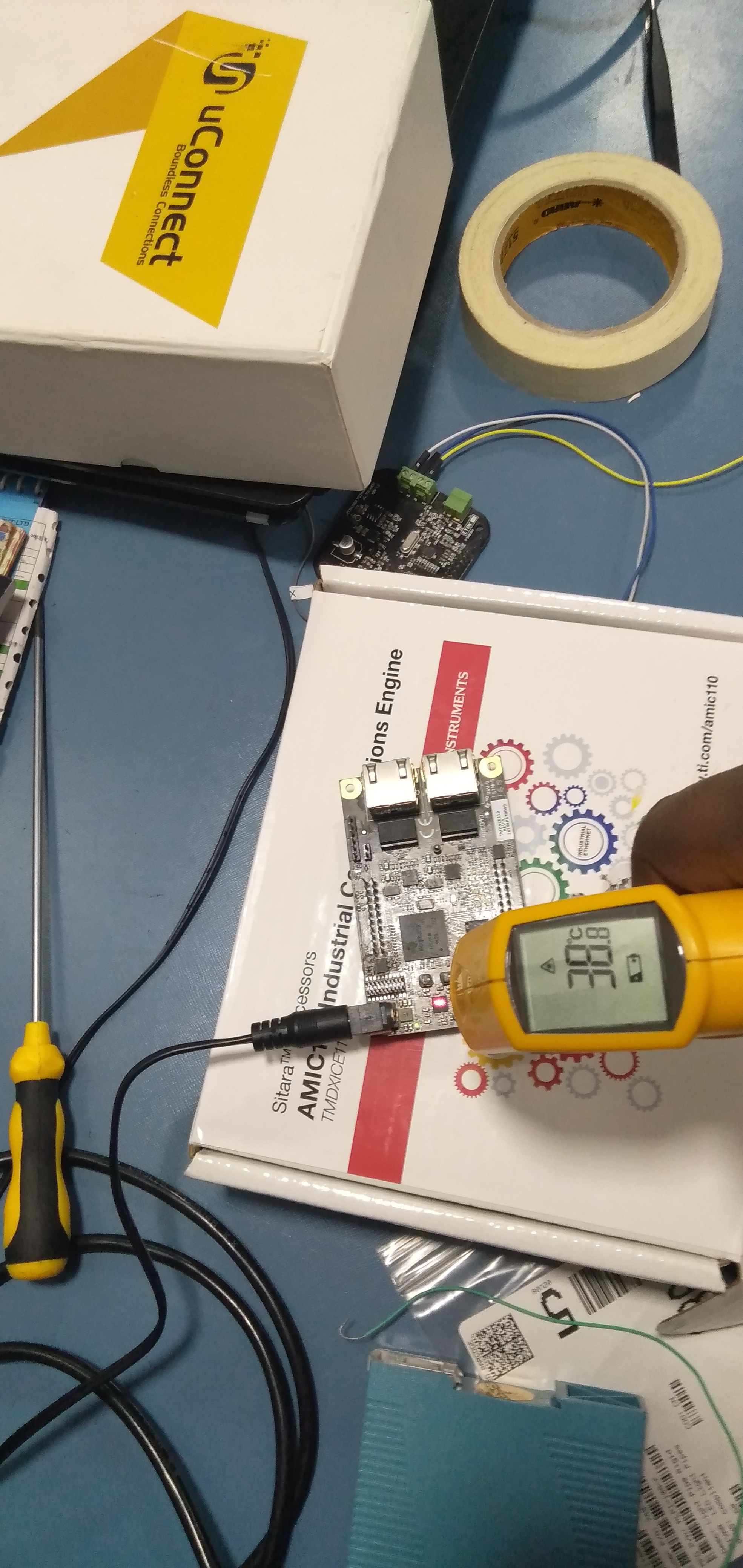

But I have noticed that PMIC (TPS650250) is getting heated up when i connect power supply.
And one more thing that i have noticed is during power on 2 LEDs(D15 and D19) should ON. But only D15 is ON, D19 is OFF.

    It is not uncommon for the power supply components to get hot.  That is not necessarily an indication that the board is not operational.  D15 indicates that you have connected your external power supply. The other LEDs on the board are controlled by software so you won't see any activity unless you have software running. If you have a volt meter you could measure the outputs from the PMIC to determine if the device is generating the correct voltages. There are resistors in line with each of the voltage rails that can be used as probe points. These are shown on page 3 of the schematic.
    The AMIC110 requires a JTAG connection to download software to the SPI memory so an XDS100 or an XDS200 emulation pod will be needed.  Until you have the emulator pod it will be difficult to tell if there is a problem with the board.
    Regards, Bill

    I have measured the temperature up to which its getting heated up. i have attached that pic see once. that IC is heating to this temperature in just 10 sec when i power up the board. Is this not a problem? Can i Go head testing the voltages on the pin outs you specified(til now i haven't done that since i am afraid about that temperature and switching off the power supply).
  • Hi Gupta,
    PMIC power supplies are densely populated components and will generate significant heat. I'm not too concerned about the 38 degrees you are displaying. It will also heat quickly since the power supplies will become active as soon as the external supply is applied to the board. Does the power supply stabilize at that temperature or continue to rise?  I would go ahead an measure the output voltages.  That should give us an indication concerning whether the power supply is operating correctly.
    Regards, Bill
  • Hi Bill,
    I have Measured the Voltages, All Voltages Levels are as per the Specifications. So I think there is no problem with the board. Now I can buy the debugger and start programming.
