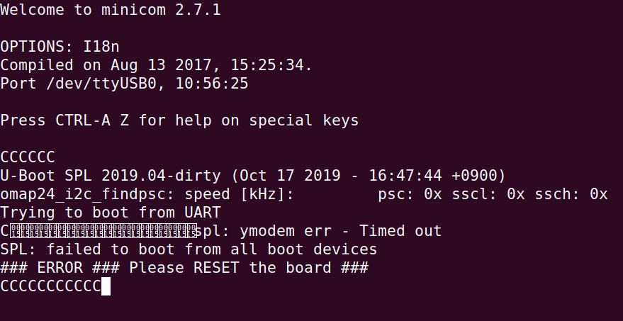

I made a new custom board using am3358.
But my device can't boot in spl step
pmic : TPS65217
eeprom : not used (to pass EEPROM check, i modified board/ti/common/board_detect.c file to hard coding)
memory : MT41K256M16TW-107 AAT (I tuned it with reference http://processors.wiki.ti.com/index.php/Sitara_Linux_Training:_Tuning_the_DDR3_Timings_on_BeagleBoneBlack )
This is my log :
Fisrt, I transfered a 'u-boot-spl.bin'.
But 'C' character was broken like above log. so I could not upload u-boot.img file after this step.
Please let me know what to check.
  • Please post the log file.
  • After sending the u-boot-spl.bin you should immediately send the u-boot.img, without waiting for "C" characters. They will not appear after u-boot-spl.bin has been sent. See software-dl.ti.com/.../Foundational_Components_U-Boot.html
  • I re-post my log image file and log using sx command
    I enable debug flag and i found a difference in ic2 result.
    minicom log on my custom board
    minicom log on beaglebone black
    sx command log on my custom board

  • Hello Hanjun,
    Please, see this thread. You need to use the u-boot-spl.bin and u-boot.img from the latest Processor SDK.
    Kemal
