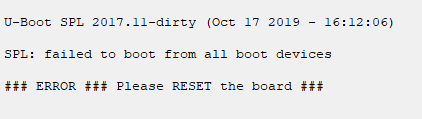

We have a custom board based on the AM3358 and we want to boot through Ethernet using BOOTP and TFTP servers.  Both the BOOTP and TFTP servers are configured using the guides found in http://processors.wiki.ti.com/index.php/Ubuntu_12.04_Set_Up_to_Network_Boot_an_AM335x_Based_Platform and http://software-dl.ti.com/processor-sdk-linux/esd/docs/latest/linux/How_to_Guides_Host.html#ubuntu-14-04-set-up-to-network-boot-an-am335x-am437x-based-platform  Both TFTP servers, tftpd-hpa and atftpd, were tested and work fine to send the  u-boot-spl.bin.  This wiki has also been read http://software-dl.ti.com/processor-sdk-linux/esd/docs/latest/linux/index.html#Using_the_network_.28Wired_or_USB_Client.29   The modifications seen here http://e2e.ti.com/support/processors/f/791/t/652970?PROCESSOR-SDK-AM335X-Ethernet-boot-fails were also tested.
The SYSBOOT is configured as 11001b.  When trying to boot from a SD CARD there are no problems.
Attached can be seen that Wireshark is used to observe the process and it is observed that there are some frame check sequence errors with the TFTP transfer; however, it was read on http://e2e.ti.com/support/processors/f/791/t/515767#pi320966=2 that those issues from Wireshark are in regards with a bootp process, as mentioned in the final post.  The post suggested adding CONFIG_SPL_ETH_SUPPORT and that was done.  A similar solution was found in http://e2e.ti.com/support/processors/f/791/p/558760/2048067
Our boot process stops and reports "SPL:  failed to boot from all boot devices" as seen on the attached image.
Attached:
Questions:
What could be the cause of the process stopping at this point and what can be done to fix it?
Is the Frame Check Sequence Error part of the problem?
Are there some configurations that could be missing?
Thank you for your time and help.
  • Jesus,
    I looked into this closer and it seems like Ethernet-based boot on AM335x has been broken for a while. My understanding is that when the Ethernet driver in U-Boot got converted to "driver model" (CONFIG_DM_ETH) the impact this conversion has on the SPL was not considered appropriately. Specifically, the Ethernet driver is reliant on the board-specific device tree file for configuration including the configuration of the PHY. However since AM335x platforms currently do not use device tree in SPL (CONFIG_SPL_OF_CONTROL) important configuration steps are not performed.
    This being said I did find a way to get a pure Ethernet-based boot to work on AM335x, by using the U-Boot that is part of Processor SDK Linux v06.00.00.07 as a starting point and adding a single patch (attached) to it to force-initialize the PHY to RGMII mode. Note that using this U-Boot as a starting point does not require adding in CONFIG_SPL_ETH_SUPPORT as it is already part of the config. With this, the board boots to U-Boot prompt without any issues as shown below.
    No this has nothing to do with it. I see the same FCS errors here, it seems like the AM335x ROM code just doesn't populate the FCS.
    Andreas

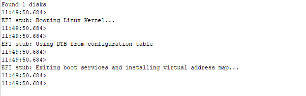

    Currently our team has gotten to where the process of booting through the Ethernet gets to where the it is able to download the zImage and attempts to boot the Linux Kernel as seen in attached.  This was accomplished by applying a custom patch to board_detect.c along with a custom .dtb and configuration for our custom board and using u-boot-2019.10.tar.bz2.  Not sure if the custom .dtb is being used being used through the Ethernet boot as our board doesn't start compared to how it starts when it is configured with the SD card.
    The issue we are having now is that it seems the custom device tree is not being selected and that the boot process gets stuck on "installing virtual address map".
    We will try your posted patch, Andreas.
    Attached:
    Thank you,
    Jesus
  • Jesus,
    without steps to re-create it's not really clear to me what is going on. Your Kernel startup hangs for some reasons not evident from the log extract you provided. Some ideas....
    • Could potentially be an issue with how your device tree file is loaded. See if you can control the load process by interrupting the boot @ U-Boot prompt and experimenting there, loading the different artifacts manually.
    • Ensure you have the 'early console' feature enabled (by configuring the Kernel command line in U-Boot appropriately, and ensuring the Kernel has the respective CONFIG options turned on). This might give you more clues. There is some related info here:
    • Try using the latest TI Linux SDK for AM335x as a starting point for your experiments rather than your custom code base, while reducing device-tree content to an absolute minimum (only activate console, no other peripherals):
    • Do you have a TI AM335x EVM? I could provide steps how to do network boot to Kernel prompt for you to re-create, this could serve as a known-good starting point.
    Regards, Andreas
  • Hello Andreas,
    I apologize for my negligence, please see attached for the full log of the terminal.  Unfortunately, the patch provided does not resolve our issue as I overlooked the fact that it forces PHY to only work with RGMII mode.  Our board currently only supports MII and that works well and fine.  Our team successfully loaded an Arago-Project kernel on our custom board by interrupting the u-boot image process and inserting tftpboot commands.  However, we want the entire process to be autonomous without any user intervention.  There are still some questions and doubts.  We are still interested in the steps you mentioned you would provide for network boot to Kernel.
    Attached:
    Terminal log file

    Loading: *#################################################################
    11:49:50.684>
    11:49:50.684>
    11:49:50.684>
    11:49:50.684>
    11:49:50.684>
    11:49:50.684>
    11:49:50.684>
    11:49:50.684>
    11:49:50.684>
    11:49:50.684>
    11:49:50.684>
    11:49:50.684>
    	 3.2 MiB/s
    11:49:50.684>
    done
    11:49:50.684>
    Bytes transferred = 3854848 (3ad200 hex)
    11:49:50.684>
    link up on port 0, speed 100, full duplex
    11:49:50.684>
    Using ethernet@4a100000 device
    11:49:50.684>
    TFTP from server 192.168.2.1; our IP address is 192.168.2.5
    11:49:50.684>
    Filename 'dtb/undefined'.
    11:49:50.684>
    Load address: 0x88000000
    11:49:50.684>
    Loading: *
    11:49:50.684>
    TFTP error: 'File not found' (1)
    11:49:50.684>
    Not retrying...
    11:49:50.684>
    libfdt fdt_check_header(): FDT_ERR_BADMAGIC
    11:49:50.684>
    78Scanning disk mmc@48060000.blk...
    11:49:50.684>
    Disk mmc@48060000.blk not ready
    11:49:50.684>
    Scanning disk mmc@481d8000.blk...
    11:49:50.684>
    Found 1 disks
    11:49:50.684>
    EFI stub: Booting Linux Kernel...
    11:49:50.684>
    11:49:50.684>
    EFI stub: Using DTB from configuration table
    11:49:50.684>
    11:49:50.684>
    EFI stub: Exiting boot services and installing virtual address map...
    11:49:50.684>
    11:49:50.684>
    Date: 10/18/2019 - 11:51:02 AM
    End log file
    Questions & Doubts:
    Following the guide in http://software-dl.ti.com/processor-sdk-linux/esd/docs/latest/linux/How_to_Guides_Host.html#ubuntu-14-04-set-up-to-network-boot-an-am335x-am437x-based-platform , does u-boot.img still search for uEnv.txt to setup different configurations when the booting process is done completely through BOOTP and TFTP?
    According to the above guide, should the kernel that is downloaded be the uImage or the zImage?  Based the guide, it only mentions zImage.
    Is there a specific way of flashing the kernel to the eMMC of the board so that it can start from that point upon reset?  Or is this process automatically done through BOOTP and TFTP?
    Thank you,
    Jesus
