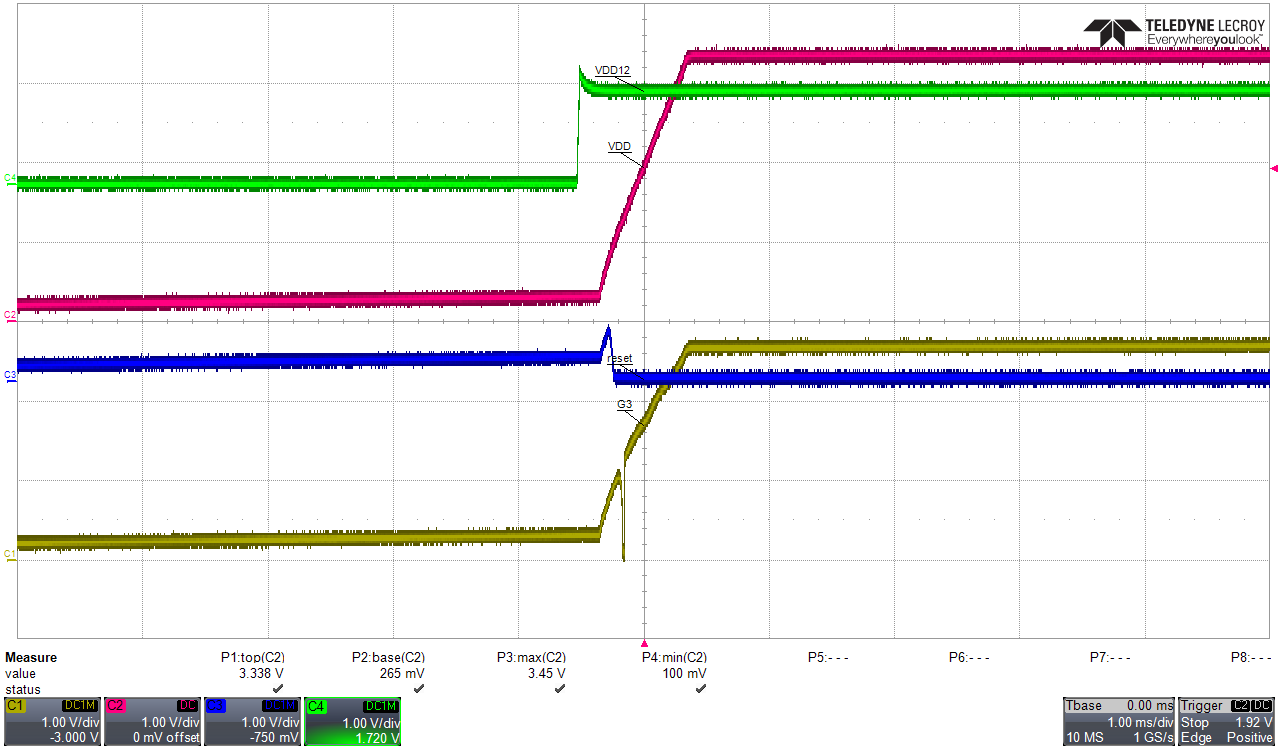

#1. on a customer's old product found pulse on G3 and C17 during power up lead to LCD flick. according to Errata, the 4.7Kohm pulled up resistor <4.81Kohm already.
#2. verified 3 boards, all have the same issue.
Seems the pin's behavior can't be explained by AM1808 errata Advisory 2.3.12. Your advice?
