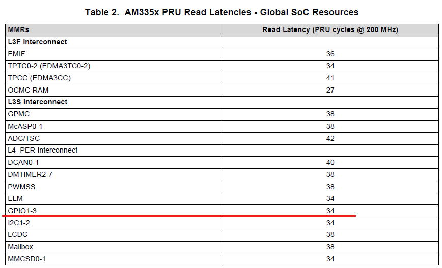

I'm using the AM3358 CPU to control my GPIO.
To improve speed, the driver has the following control:
pGPIO3 = (volatile unsigned char *)ioremap(0x481AE000, 0x1000);
pGPIO3_DIR = (volatile unsigned int *)(pGPIO3 + 0x134);
pGPIO3_IN = (volatile unsigned int *)(pGPIO3 + 0x138);
pGPIO3_OUT = (volatile unsigned int *)(pGPIO3 + 0x13C);
//write
*pGPIO3_OUT = val;
//read
val = *pGPIO3_IN;
However, GPIO Read time is much longer than write as shown below.
Is there any way to control faster without using a PRU?
Thank you.
