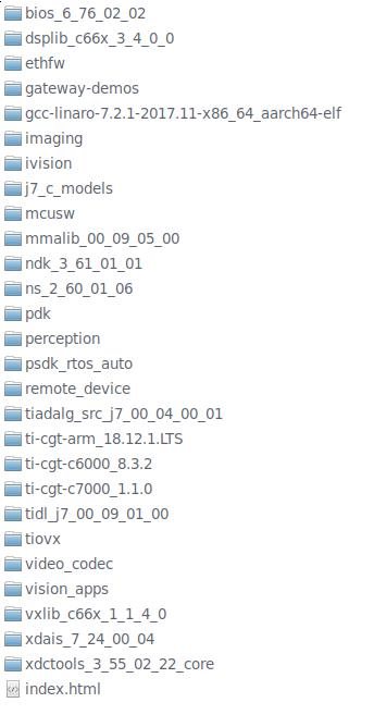

  • OK so I was digging a little further and saw that we can also flash via CCS (which works more or less).
    Unclear to me is how to flash binaries I built with the Makefiles from the pdk folder.
    Also unclear is the memory mapping of the DSPs (datasheets is not complete here). So if you could provide valid Linker files this would be great.
    And I still cannot find how to build, configure and install/flash the TI RTOS for the DSPs which seems to be required for many examples.
    This is what we have, i built all in the "pdk" folder like the user guide says, but I cannot find an RTOS there.
    I think we must install the RTOS somehow in the CCS and configure it there, but the user guide is old and does not work.
    Please give me something to work with the board.
    Best regards
    Jan
  • Jan,
    The OpenVX framework implementation from TI is "TIOVX", so in the tiovx folder of the sdk, you will find the user guide link from the release notes in the tiovx folder (redirects to the docs/user_guide/index.html).
    There was a new release last week, PSDKRA 6.01, which has many updates to the user guide.
    In here, there is a section which points to the tutorial (which has some simple examples), as well as how to add custom kernels using pytiovx script.  OpenVX contains several vision processing functions, but we expect customers to uses the plugin interface to add their own offload compute functions so they can call their algorithm from the A72 in a pipelinable graph for full utilization of our heterogeneous architecture.
    Is this what you are looking for?  Since it doesn't use OpenCL, there are several callbacks which need to be registered on both the A72 side as well as on the target (DSP, R5F, etc) side, which get compiled into those binaries.
    Jesse
