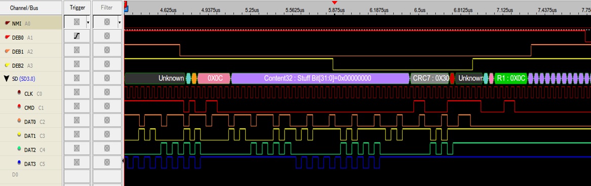

    However, if SW set the GPIO pin depends on the value of CLEV by pollin it while CMD line change its status dynamically then GPIO signal and CMD line signal doesn't match its status.
    Please refer to the picture.
    DB2 is GPIO siganal which indicates the result of CLEV polling.
    I expect that the status of DB2 signal matches with the status of CMD signal.
    Therefore, I'm afraid that the CLEV has big latency.
    How long is the delay before the CMD line status is reflected in CLEV?
    (I know there is possibility that GPIO and SW polling also has latency.)
    Thanks and Best regards,
    HaTa.
  • It appears you are operating the interface at 24MHz and the pulse width of CMD can be as short as 41.67ns. You would need to poll CLEV at a frequency greater than 50MHz to detect toggles.
