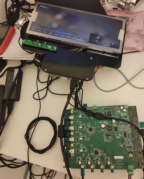

Hi!
I am developing on the TDA2Px EVM with fusion application board ? and use the PROCESSOR_SDK_VISION_03_07_00_00.
I use the IMX390, AR0233 cameras with the Coax connectors.

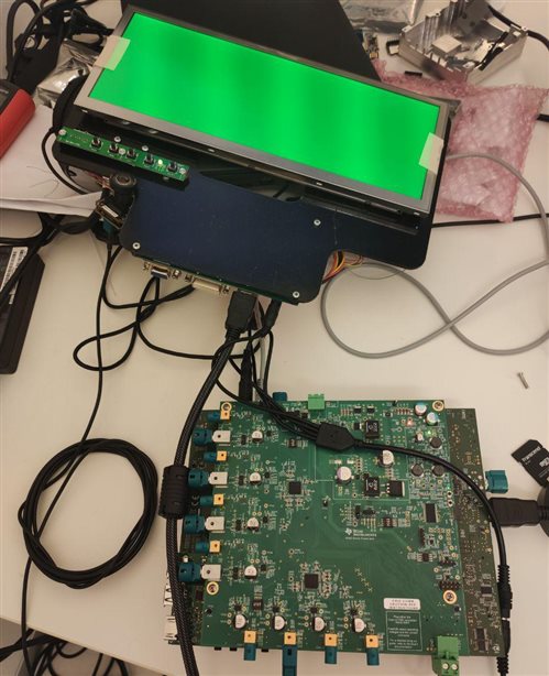

I'm running the issIspSimcop_Display usecase (1CH ISS Capture) and I receive the image on display when I connect camera to connector Cam0
I want to test the single ISS camera capture from other connectors, using deserializer #0(for cameras)cam0..cam3 and deserializer #1 (for radars) radar0..radar3 and connect the camera to any of 4 CAM and 4 RADAR coax connectors
But when I connect  camera to connectors Cam1..Cam3 I receive only green screen and error message in console:
[IPU1-0]     16.269505 s:  i2cMdSubmitChan: i2c4 transfer to slave address 0x76 failed
[IPU1-0]     16.269627 s: src/bsp_deviceI2c.c @ Line 580:
[IPU1-0]     16.269718 s:  I2C4: DEV 0x76: WR 0x01 = 0x02 ... ERROR !!!
[IPU1-0]     16.270023 s: src/bsp_deviceI2c.c @ Line 602:
[IPU1-0]     16.270084 s:  I2C4: Error timeout 1 ms!!!
[IPU1-0]     16.270145 s: Could not configure serializer !!!
[IPU1-0]     16.270206 s: Failed to initialize the serializer on camera # 0!!!
[IPU1-0]     16.270298 s: --- IssUtils_appInitUb960
[IPU1-0]     16.270359 s:  Assertion @ Line: 512 in /home/git/PROCESSOR_SDK_VISION_03_07_00_00/vision_sdk/apps/src/rtos/iss/src!
[IPU1-0]     16.271060 s:  Assertion @ Line: 512 in /home/git/PROCESSOR_SDK_VISION_03_07_00_00/vision_sdk/apps/src/rtos/iss/src!
I was trying to change the camera settings from iss_sensor_tda2px.c but no results:
 switching PORT_0_SENSOR_ADDR and PORT_0_SER_ADDR to  PORT_1_SENSOR_ADDR and PORT_1_SER_ADDR
Also I was trying to use the second deserializer (for radars) with the cameras:
I switched the i2c addresses of the deserializers in code 0x36 and 0x3D -

So, how can I modify the code to test the single ISS camera capture using different from the camera channel #0 on fusion application board?
