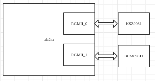

TDA2SX: How to use GMAC_3W as ethernet switch
Part Number: TDA2SX
I am currently using tds2sx for development, and the VSDK version is 03-06-00-00. I want to realize the Ethernet switch function of GMAC_SW module in Linux. The schematic diagram of Ethernet hardware connection is shown in the figure.
 I tried the following:
1)In devicetree, I discribe the mac like this:
	&mac {
	status = "okay";
	  slaves = <2>;
	  active_slave = <0>;
	  pinctrl-names = "default", "sleep";
		pinctrl-0 = <&rgmii1_default>;
		pinctrl-1 = <&rgmii1_sleep>;
		dual_emac;
	&cpsw_emac0 {
		phy_id = <&davinci_mdio>, <0>;
		phy-mode = "rgmii";
		dual_emac_res_vlan = <1>;
		fixed-link {
		      speed = <100>;
		      full-duplex;
	&cpsw_emac1 {
		phy_id = <&davinci_mdio>, <2>;
		phy-mode = "rgmii";
	  fixed-link {
		      speed = <100>;
		      full-duplex;
	&davinci_mdio {
		status = "okay";
		bcm89811: ethernet-phy@0 {
			reg = <0>;
			br_master;
		ksz9031: ethernet-phy@1 {
			reg = <1>;
2) Select the relevant option in the driver
	CONFIG_TI_KEYSTONE_NETCP=y
	CONFIG_TI_KEYSTONE_NETCP_ETHSS=y
	CONFIG_TI_KEYSTONE_NETCP_PA_CORE=y
	CONFIG_TI_KEYSTONE_NETCP_PA=y
	CONFIG_TI_KEYSTONE_NETCP_PA2=y
	CONFIG_TI_DAVINCI_EMAC=y
	CONFIG_TI_DAVINCI_MDIO=y
	CONFIG_TI_DAVINCI_CPDMA=y
	CONFIG_TI_CPSW_PHY_SEL=y
	CONFIG_TI_CPSW_ALE=y
	CONFIG_TI_CPSW=y
	CONFIG_TI_CPTS=y
	CONFIG_TI_CPSW=y
	CONFIG_TI_CPTS=y

4.I set ip for eth0 and eth1 manually
  eth0      Link encap:Ethernet  HWaddr 6C:C3:74:2B:63:91
          inet addr:169.254.188.1  Bcast:169.254.255.255  Mask:255.255.0.0
          inet6 addr: fe80::6ec3:74ff:fe2b:6391%132400/64 Scope:Link
          UP BROADCAST RUNNING MULTICAST  MTU:1500  Metric:1
          RX packets:399 errors:0 dropped:0 overruns:0 frame:0
          TX packets:143 errors:0 dropped:0 overruns:0 carrier:0
          collisions:0 txqueuelen:1000
          RX bytes:79087 (77.2 KiB)  TX bytes:28938 (28.2 KiB)
          Interrupt:82
eth1      Link encap:Ethernet  HWaddr 6C:C3:74:2B:63:91
          inet addr:169.254.188.2  Bcast:169.254.255.255  Mask:255.255.0.0
          RX packets:262 errors:0 dropped:0 overruns:0 frame:0
          TX packets:122 errors:0 dropped:0 overruns:0 carrier:0
          RX bytes:43161 (42.1 KiB)  TX bytes:27412 (26.7 KiB)
5. Set the ip1 address of pc1 to 169.254.188.9, and the IP address of PC2 to 169.254.188.10
The ping test on PC1 shows that both 169.254.188.1 and 169.254.188.2 can be connected
On PC2, the ping test showed that 169.254.188.1 and 169.254.188.2 could not be connected
PC1 and PC2 cannot be connected
6, So, If I want PC1 and PC2 to connect, how do I modify my device tree and driver?
Thanks!
  • Hi
    The driver supports two modes of operation.
    1. standalone mac mode of operation, where we emulate two independent Ethernet ports(no forwarding between the ports)
    2. Ethernet switch mode, with address learning, forwarding between ports in HW
    The selection is through the device tree parameter - "dual-emac" property in the DT will set it up in standalone MAC mode. You can drop this parameter if you want to use the other mode.
    Also, your device tree configuration seem to indicate fixed link, MAC-MAC direct connection. Please review and confirm if this is what you intended
