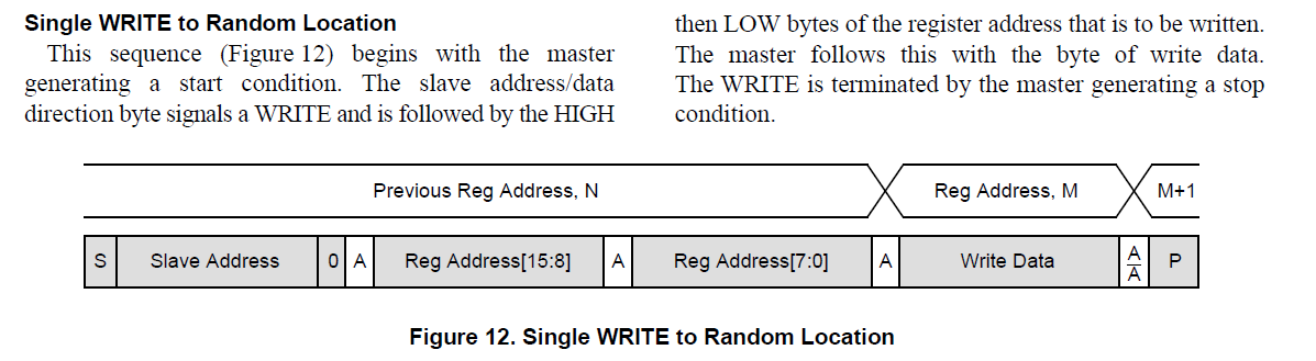

I have an ar 0134 sensor. I need to change the values of the RGB colors in the registers. We know the addresses of the RGB registers. Namely: green1 gain, blue gain, red gain and green2 gain. The transfer of register values is via the I2C interface. Question: how can register values be changed in the project code vps_captureVipExample_idkAM572x_armExampleProject?

  • Okay, I modified part of the project code vps_captureVipExample_idkAM572x_armExampleProject:

            UART_printf("Set values:\n");
            //for sensor ar0134
            UInt16 addr = 0, val = 0;
            //green1 gain
            addr = 0x3056;
            val = 0x0048;
            Bsp_deviceWrite16(decI2cInstId, decI2cAddr, &addr, &val, 2);
            BspOsal_sleep(10);
            //blue gain
            addr = 0x3058;
            val = 0x0050;
            BspOsal_sleep(10);
            //red gain
            addr = 0x305A;
            val = 0x0052;
            BspOsal_sleep(10);
            //green2 gain
            addr = 0x305C;
            val = 0x0054;
            BspOsal_sleep(10);

  • Yan,
    It appears you're on the right track. Here's what I see in the AR1034 datasheet:
    I'm not clear on whether the green1 gain, etc. registers are 8 or 16 bits. For 16 bit registers, I'd use Bsp_deviceWrite16() like you already have. For 8-bit registers, I'd try using Bsp_deviceWrite_Custom_16A8D().
    Do you see any activity on the I2C bus?
    Frank
