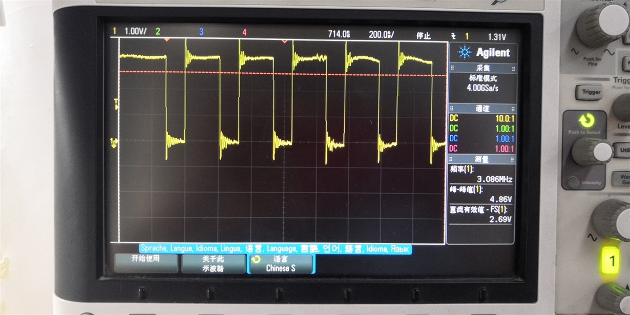

The EMIF read time is measured with an oscilloscope. As shown, a high level indicates a wait time between reading and reading, and a low level indicates a reading time. According to the EMIF user manual of the C6657, I have set the EMIF A3CR register Turn Around cycles to 0, but still have a wait time of 200ns. Further debugging found that the wait time does not change regardless of the configuration of the TA segment of the A3CR register. The wait time between reading and reading is much longer than the time it takes to read.
1. Is there any way to configure the wait interval between reading and reading?
