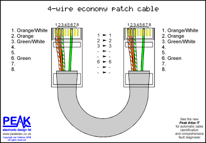

   I connected the EVM board to the router using a 4-wire cable (100M) and could not automatically create a 100M link, but the  link is created on 1G and the communication is not ok. The order of the wires is as follows:
100BASE-TX 100Mb/s 802.3u 2 pairs: pins 1,2,3,6 CAT5 copper cabling with two twisted pairs.
But I connect my PC to router with the same net cable, My PC can auto create link with router.

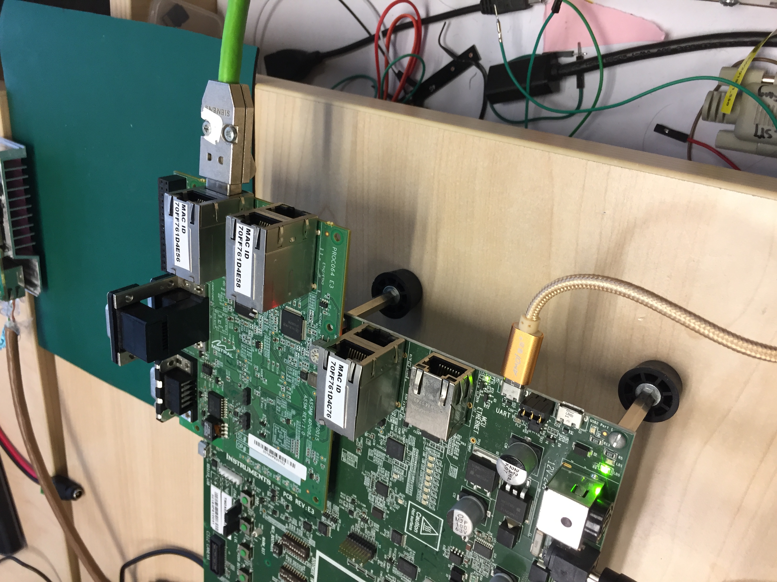

  • I would like to confirm which Ethernet port on the EVM you are trying to connect to the router.
    What pins do each of pins 1, 2, 3, and 6 connect to on the other end of the cable?
    Does your router support auto-MDIX?
    What do you mean with your comment "link is created on 1G and the communication is not ok."?
    Paul
    The 4-wire(100M) network cable is as follows:
    I confirm my router supports auto-MDIX.
    I use ethtool to check the link status and found that the link is successfully created on 1G, the log is as follows:

    The issue is the cable that you are using with the TI EVM. The PHY on the TI EVM is advertising that 1Gbps is supported and that is what the link is negotiated to which is beyond what your cable can support. The cable that you are using is limited to 100Mbps due to the number of conductors in it (4), 1 Gbps requires 8 conductors. Therefore essentially none of the data is getting through as I imagine that all the packets are getting dropped as malformed.
    If you want to use the 4 conductor cable you will have to limit the link speed that is advertised. This might be done by limiting the max speed of the PHY in the board dts file. I don't have a setup handy that matches yours but you will need to do something like this for the cpsw port:
    &phy1 {
                   max-speed = <100>;
    The above code is from this file from another TI processor that limits the speed on the PHY for eth1 located here as a reference arch/arm/boot/dts/am57xx-beagle-x15.dts. I stress that the above code will not work directly and will need to be modified for the AM65x EVM.
    The other method is to modify the resistor strapping on the PHY that manages the link speed on the EVM. I usually recommend against doing this on the TI EVM as it takes away the nature of the board as being general purpose and what TI calls a golden reference for assistance from TI. The modification makes the board specific and might be forgotten and add to later debug issues.
    Schuyler
    Thank you for your help. The EVM board  can't auto-negotiate into 100M with 4-wire cable? But I know my PC is able to auto-negotiate into 100M with the same 4-wire cable.
    What I was describing in the last post is that the EVM has to have its 1G advertised link mode capability removed through either a HW or SW change so only 100M and 10M speeds are advertised by the EVM. To my knowledge auto-negotiation will always start with and negotiate to the highest advertised link speed supported by both link partner. Since both link partners support 1G  then that will be the link speed. As an experiment if you have an old 10/100 switch place that in between the two link partners and see if that allows this 4 wire cable to work.
    Schuyler
  • Hello Schuyler,
    We have done some tests shown below
    Case Endpoint A Cable Type Ednpoint B Status
    #1 EVM 1G port 8Pin 1Gbps PC 1G port Linkup with 1Gbps, working
    #2 EVM 1G port 4Pin 100Mbps PC 1G port Linkup with 1Gbps, not working
    #3 PC 1G port 4Pin 100Mbps PC 1G port Linkup with 100Mbps, working
    #4 EVM 1G port 4Pin 100Mbps PC 100Mbps port Linkup with 100Mbps, working
    I think for case #2, the link should auto-negotiate to 100Mbps which should be same as case #3 (PC to PC).
    Am I missing anything?

    Hardware:
            board: AM654x EVM PROCESSOR BOARD PROC062
            ethernet port: ICSSG0 PRU ethernet
    Software:
            SDK6.1
    The ethernet port of EVM is connected to a switch that supports 1G / 100M / 10M using a 4-wire network cable, this log is

    and the photo of board is

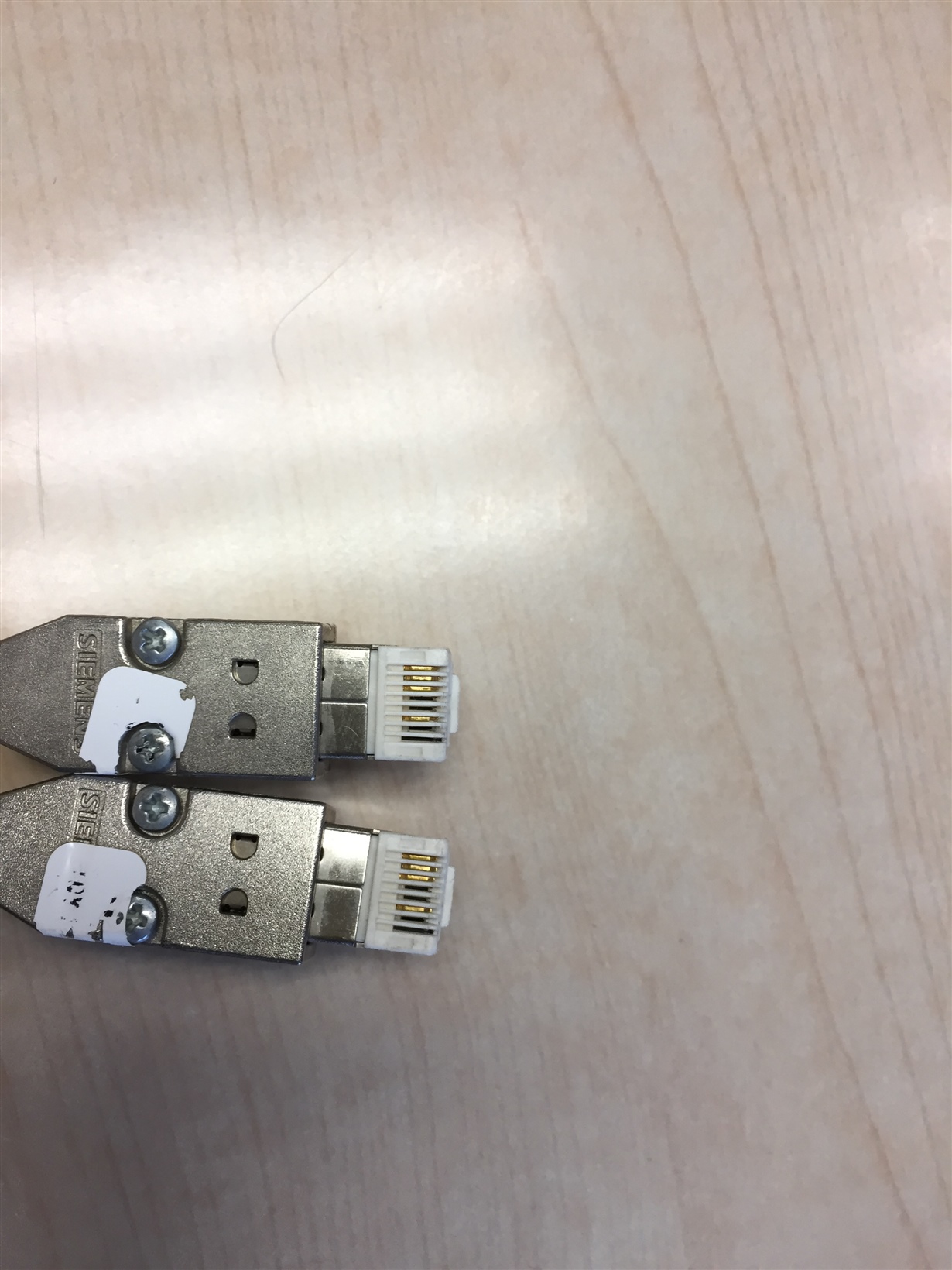

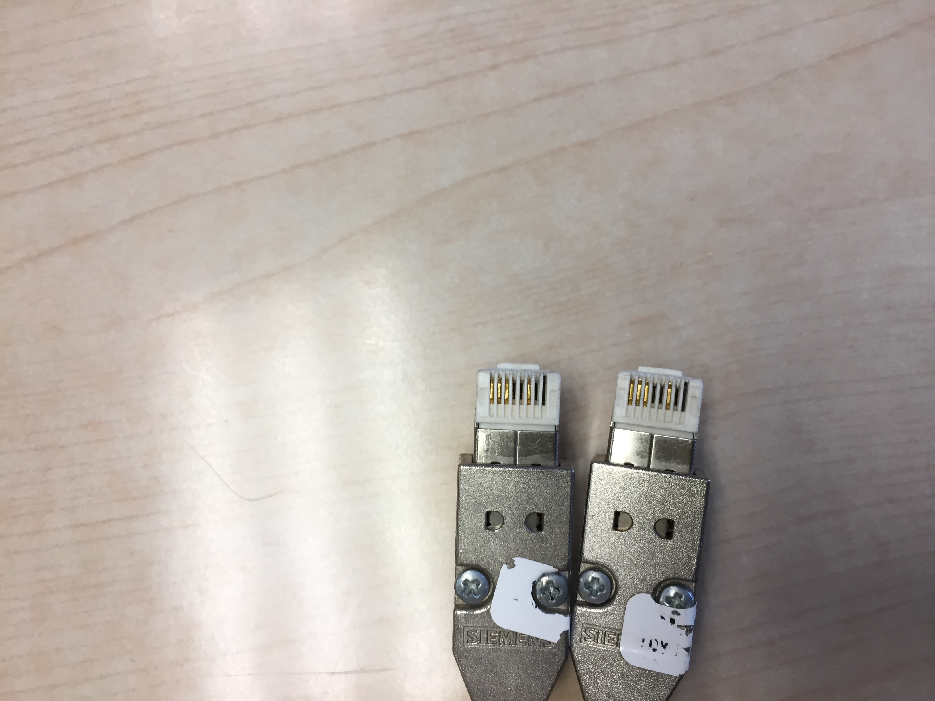

    We are using a 4-wire cable, this is a normal cable, not a special cable. If you do not have a 4-wire cable in your lab, you can manually make a 4-wire cable with reference to the figure below:
    I made a cable as you have described when I conducted my testing. Other than speed optimization, are you making any other register writes? Are you using mirror mode?
