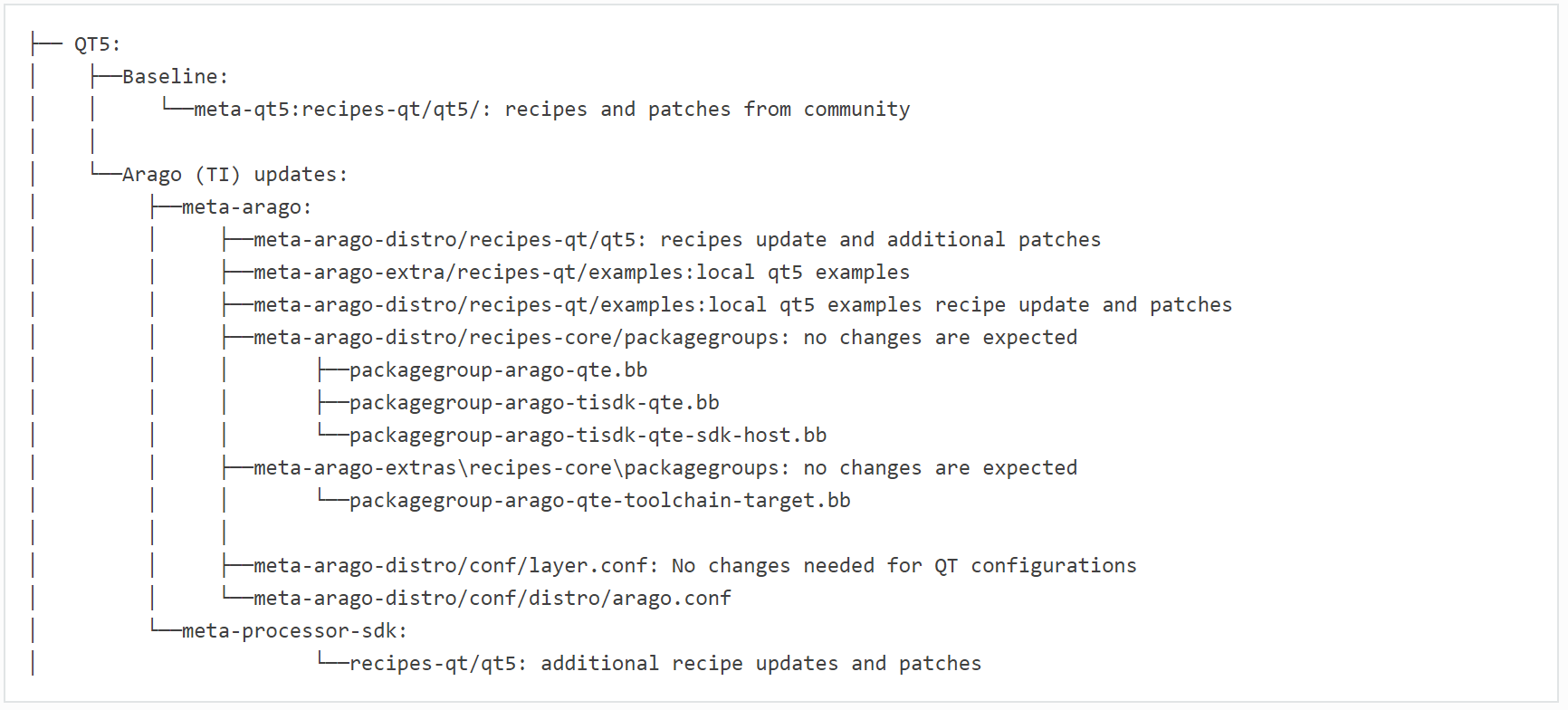

    Is there any doc ,how to build custom qt5 with opengl support  uing the new TI sdk,such as TI SDK V03_03_00_04?
    when I build the Qt5.5.1 meet the problem
    backend/qgraphicscontext.cpp:1035:22: error: ‘Qt3D::QAttribute::DataType’ is not a class or namespace
    Best regards
    wangl
    We use the Yocto Project to integrate Qt into our PSDK and here are a couple of links to get you familiar with Yocto:
    1. http://software-dl.ti.com/processor-sdk-linux/esd/docs/latest/linux/Overview_Building_the_SDK.html
    2. https://training.ti.com/customizing-yocto-for-production-packagegroups
    Here is an image that describes all the recipes we have modified for Qt:
    Krunal
