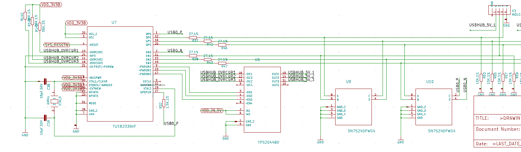

I have a custom made board with an AM3358 using DDR3 memory that is working stable.

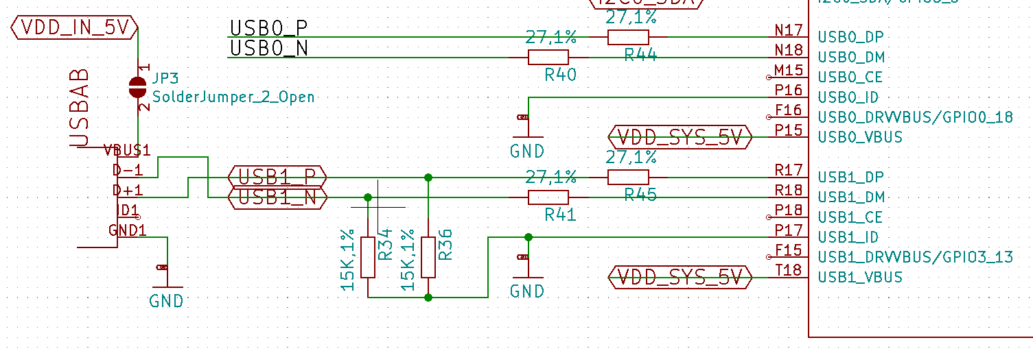

My setup is that USB1 is connected to a micro USB port as a HOST, and USB0 is connected to a TUSB2036 on the PCB to make a 3-port USB hub.

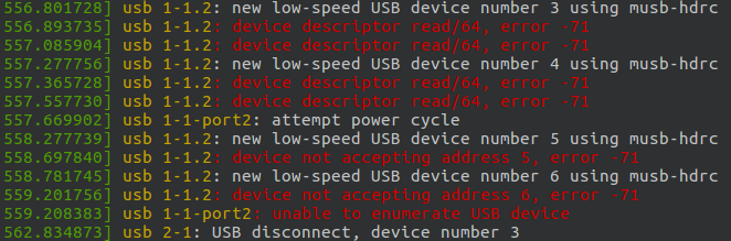

The problem I have is that USB0 can find the HUB, but the USB device plugged in the HUB is not getting registered. USB1 seems to work fine.
I have measured and have 5V on the downstream USB port, and I verified the DP DM connection on the downstream ports.
I hope someone has an idea. Below I listed more details.

The connection on the AM3358 side:
The TUSB2036 connection, followed datasheet typical connection:

And now the problem, when I plugin a USB device (in this case a USB stick) in the hub I get these messages from "dmesg":
