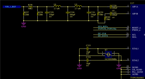

Hi,  I'm doing board bringup on a custom board to capture and encode h264 video from on a dm365, from a NTSC camera via a tvp5150 decoder.
  • DM365 custom board, with TVP5150 YOUT to a 74CBTLV16210DL switch, to DM365 YIN
  • NTSC input from camera to TVP5150
  • modified DMAI based recorder test application
  • YCINSWP added: ccdcfg |= CCDC_YCINSWP_YCBCR in dm365_ccdc.c driver.
  • Using tvp5150 driver from DVSDK3.0
The recorded video has some vertical line noise, and some pulsing intensity artifacts.  Attached is a sample recorded video.
Any ideas what settings might be causing this sort of problem?  It appears to be some sort of misconfiguration, but I have not been able to pinpoint it.  There was some flywire rework to the lines between the TVP5150 and the switch, but as this is a digital signal, i expect that it would not introduce video noise of this sort.

  • Can you share your schematics which show the connectivity of the TVP5150 to the DM365 please?
    Could you also print out a luma ramp which goes from white to black gradually across the page then point your camera at this so I can see how the image behaves with a more controlled image.
    It would also be helpful to fo the same for color ramps of red, green and blue.
    BR,
    Steve
  • Hi Steve,
    I've forwarded the schematics to your email.  Here are the videos of white+rgb ramps.   Looks like the G and B ramps in particular are very messed up in color space.  Apologies for poor quality, I don't have access to an NTSC signal source other than my camera, so I've just pointed it at a monitor...
    Mitch Rybczynski
  • Mitch,
    This looks like one of two possibilities.
    1) The data is changing too close to the clock edge which might be causing the previous sample to be captured rather than the new sample. Since luma and chroma are interleaved it can cause the two to be mixed somewhat. It can also cause noise on samples where high order bits change state
    2) The input port needs to be configured correctly to accept data a) on the correct clock edge and b) in the correct format, e.g. YUYV or UYVY.
    A combination of the above 2 possibilities may also be causing the 'noise'.
    My feeling is that it may be a clock issue causing luma and chroma to be effectively swapped some times since if you look at some of the 'flat' areas there are very well defined vertical lines which looks like chroma is being interpreted as luma and since chroma alternates between U & V we see alternating pixels.
    If possible either invert the pixel clock (not sure if this is possible through DM software registers or not but the TVP5150 cannot invert the clock) or delay the clock slightly with a buffer.
    BR,
    Steve
  • Thanks Steve,
    It turned out to be our filtering of the input signal to the TVP5150, once we bridged out the filter network here, video was suddenly clear:
    Mitch
  • Glad you are now clear.
    Where did you get this filter design from?
    It is preferable to have an anti-alias filter on the inputs. This is not critical, but the image quality will then depend a little more on the video source re-construction filter quality if there is no anti-alias filter on your input.
