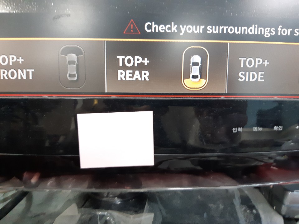

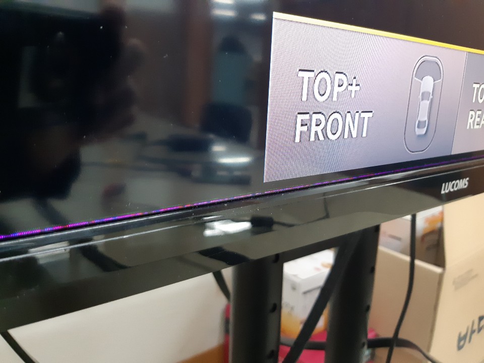

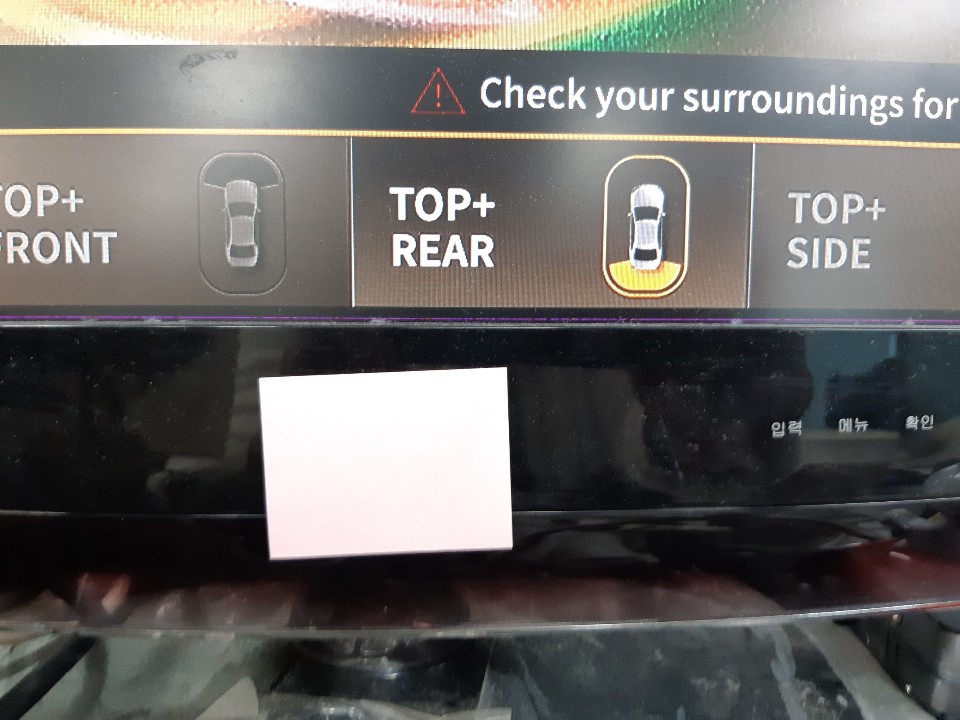

The issue is that 1 blue line is displayed at bottom of screen.
I think this issue is internal signal problem such as DE, Hsync, Vsync...
I tested using VSW bits of the register HDMI_WP_VIDEO_TIMING_V.
1. VSW = VSW + 1 when the monitor is displaying
-> Top 1 line not visible originally is displayed and bottom 1 blue line is not shown.
2. Removing and inserting hdmi connector.
-> Top 1 line is not shown and bottom 1 blue line is displyed despite of VSW == Vsync + 1.
It's equal to original problem.
In conclusion, hdmi monitor recognize start of valid screen after first 1 line.
