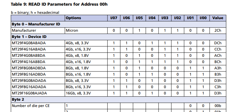

I used TMDSLCDK138. The nand flash is MT29F4G16ABADAH4:D. What's the device ID? How to read the ID?
https://pdf1.alldatasheet.com/datasheet-pdf/view/526231/MICRON/MT29F4G16ABADAH4.html
I want to learn how to check parameter referred in below link Supported NAND Devices.
