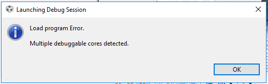

    whenever I try to load the out file to the target with proper target_configuration file, it always returns error pop up "Load program error : Multiple debuggable cores detected". Can you please help me in flashing it using CCS? Thanks in advance.

  • >> whenever I try to load the out file to the target with proper target_configuration file, it always returns error pop up "Load program error : Multiple debuggable >> cores detected". Can you please help me in flashing it using CCS? Thanks in advance.
    I tried the CCS 9.0.1 with the AM473x GP EVM (XDS100v2 on board emulator, J21) using the default gel file. I was able to load the pdk_am437x_1_0_15\packages\ti\starterware\binary\qspi_app_flash_writer\bin\am43xx-evm\gcc\qspi_app_flash_writer_a9host_debug.out to CortexA9 and run it without any issue, although the qspi flash is not available on my GP EVM.

    I also followed same steps. I'm trying to flash pdk_am437x_1_0_15\packages\ti\starterware\binary\uart_app_echo\bin\am43xx-evm\gcc\uart_app_echo_a9host_debug.out file to EVM AM437x target configuration. I think I'm over looking / missing some steps you're performing. Herewith I've mentioned step by step what I did. please let me know if anything is wrong. Thanks.

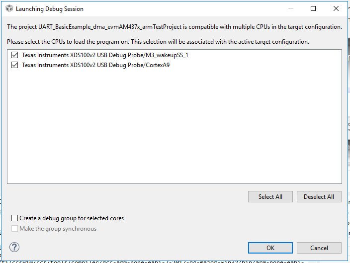

    8. It opened a pop-up asking for which core to be used [as below].
    9. I selected Cortex A9 core & unchecked cortex -M . [even tried selecting both options enabled].
    10. still getting same "load program error - multiple debuggable cores detected".
    is there any prior setting in CCS/Board that I'm missing?

  • Hi Ming,
    At last I'm able to load the program built using GCC & flash it using CCS.
    I followed below steps:
    1. Click on Target -> Reset CPU
    2. Click on Target -> Load Program
    3. Select the executable file to be loaded.
    4. It started loading the out file in CCS generated using GCC.
    Thanks a lot for the support. I'll continue my testing from here.
