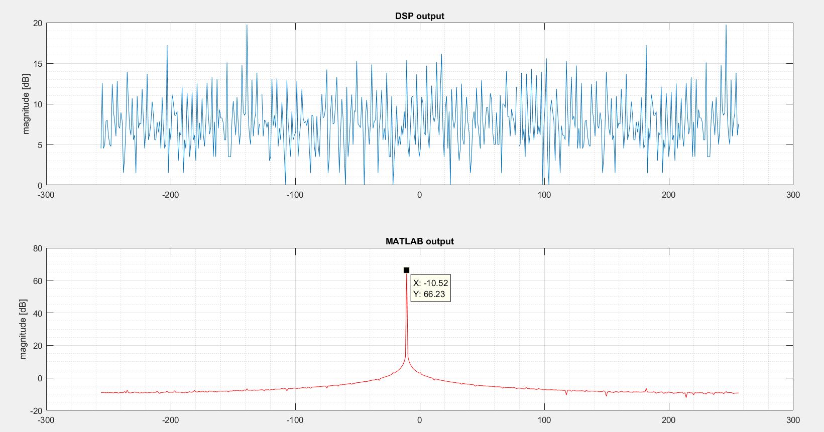

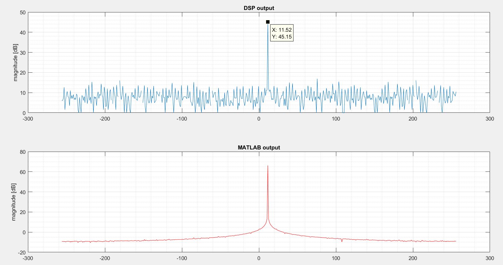

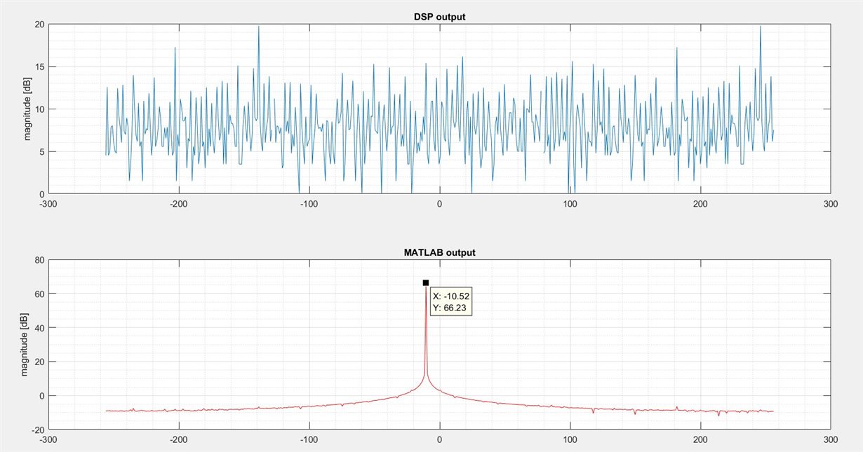

Hi All.
I have few questions, regarding EVE simulator:
  1. Once I provide to EVE negative sinusoidal signal
input_signal = sine();
I got a lot of noise and I did not get proper FFT result (have a look at attached files for positive and negative signals).
  1. I have different amplitude as well.
  2. The scaling factors are zeros and I generate the signal with next Matlab code:
bits = 13;
Fs = 512;
noise_ratio = 0;
sine = dsp.SineWave();
sine.Amplitude = power(2,bits);
sine.Frequency = -11;
sine.SamplesPerFrame = Fs;
sine.SampleRate = Fs;
sine.PhaseOffset = 0*pi;
sine.Method = 'Trigonometric function';
sine.ComplexOutput = true;
sine.OutputDataType = 'single';
Additional information:
When i try to debugging, i found, that reference function:
"vcop_fft_npt_32inter_mixed_radix_cn"
found proper frequencies.
Please advise,
Sergey.
  • Hi Sergey,
    May be there is an issue with the EVE implementation since vcop_fft_npt_32inter_mixed_radix_cn() is correct. What are the FFT parameters you used to initialize the FFT applet ? So I can reproduce the issue with your configuration ?
    regards,
    Victor

    My configuration are:
    inputData = "../testvecs/input2.txt"
    outputData = ""
    dopplerCorrectionBuf =
    enable32bitsIntermResults = 1
    enableDopplerCorrection = 0
    dopplerCorrectionScaling = 0
    numPoints = 512
    numLines = 1
    scaleFactor = 0 0 0 0 0 0 0 0 0 0 0 0 0 0 0
    enableOverflowDetection = 0
    randSeed = 1
    numIter = 1
    Please find in attachment my input file.
    Sergey.

  • Hi Sergey,
    Thanks. I'll try in a couple of days. In the meantime, can you test with enable32bitsIntermResults= 0 ?
    regards,
    Victor
  • Hi Sergey,
    Could you test wih enable32bitsIntermResults= 0 ?
    regards,
    Victor
  • Hi Sergey,
    I apologize, I haven't had time to look at the issue yet. In the meantime, did you try enable32bitsIntermResults= 0 ?
    regards,
    Victor
  • Dear Victor.
    Thanks for your time.
    Finally i compiled the project with VS2012 and all there is no issue anymore.
    Sergey.
