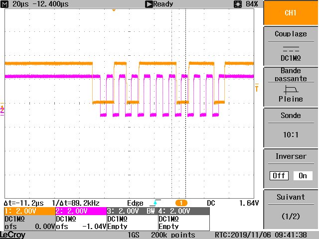

    BEFOR the start command :
    I can see that the "I2C_CON" is Enabled and configured as Master in TX mode
    AFTER the start command, before the put command :
    I can see this (=0x5C) on the bus...

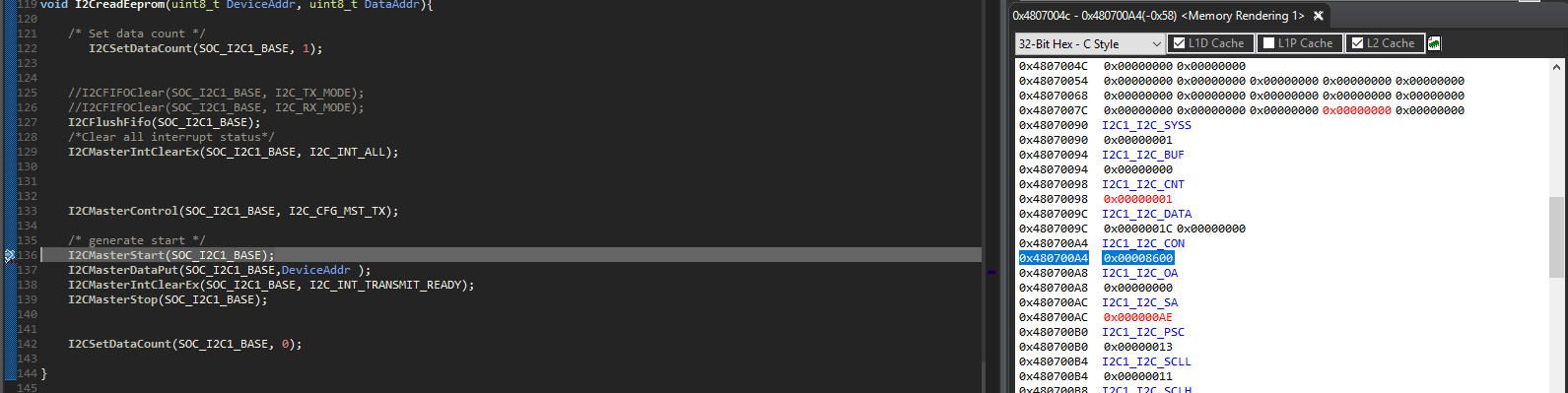

    Moreover
    The "I2C_CON" is now : Enabled and TX mode
    BUT
    the Master bit (I2C_CON[10](MST)) felt down and the Start condition bit (I2C_CON[1](STT)) didn't rise up.
    In addition we can't see on this pic but I2C_IRQSTATUS_RAW[7] (AERR) = 1 and I didn't find any way to shut it down.
    AFTER put command :
    Finally we can see that after the "put" command the "I2C_DATA" remains the same, so the "put" command didn't accessed the register and nothing happened on the bus.
    In addition we can't see on this pic but still I2C_IRQSTATUS_RAW[7] (AERR) = 1 and I didn't find any way to shut it down.

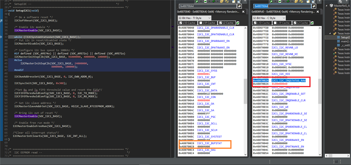

    I tried to follow step by step the methode  page 5744 of  the DataSheet, but nothing seem to work. the AERR rise whenever it want, and bus activity still happend on the return of "I2CMasterSart".
    I've look upstream in the code, it appears that the "AERR" bit rise up (red) at the enable of the I2C module in the "Setup" sequence, even if the FIFO is empty (orange) :
    So the problem must be before,

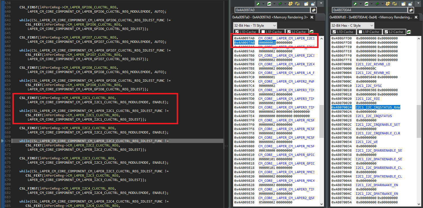

    - I've check the pinmux. The code does go through :
    pinmux.c ==> PinmuxI2cConfig() ==> case1
    - I've check the clock, which is active  :
    I'm digging but I can't find anything.... Do you have an idea?

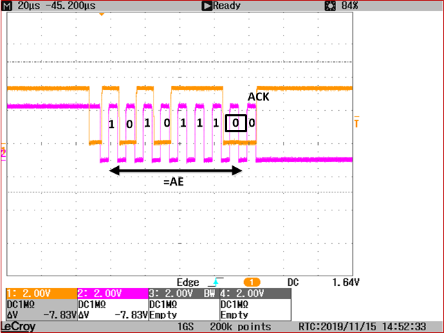

  • Hi Marine,
    I'm not sure why you're seeing this behavior.
    I notice your slave address is 8 bits, but you're configured for 7-bit addressing mode. Your scope capture seems to show the least-significant 7 bits of the 8-bit address being transmitted for a Read transaction.
    First bits transferred: 0 1 0 1 1 1 0, these are 7 LSBs of 0xAE.
    However, it looks like this is followed by:
    • R/W_ = 1 (Read)
    • ACK = 1 (NACK)
    Does your slave require an 8-bit address?
    Frank
  • Hi Frank !
    I do thank you for your answer !
    It was my problem, I didn't understood well the address management, now I can send the right frame and the device ACK to it.
    Thanks a lot !
