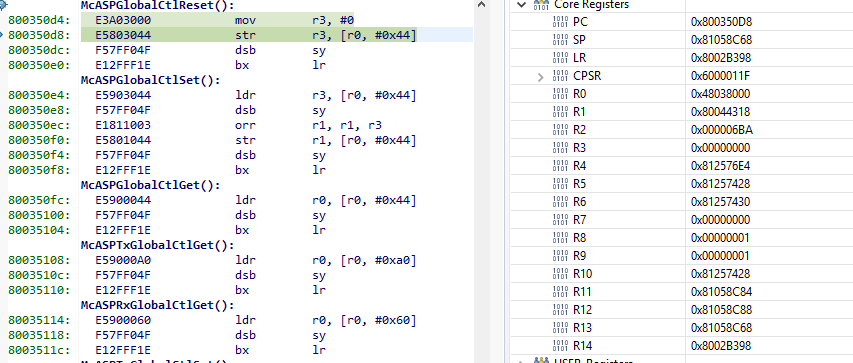

I'm trying to use the McASP on a BBB.  I've been able to build the MCASP_Audio_evmAM335x_armExampleProject for the BBB and get the McASP initialized.  I've made all the changes to my project needed based on the sample project but it fails calling  mcaspBindDev.   Here's the configuration information:

Stepping into the call I found that it's failing when trying to reset the McASP device on the line that writes to the config register
Debug output
[CortxA8] 0x48038000 R8 = 0x00000001
R1 = 0x80044318 R9 = 0x00000001
R2 = 0x000006ba R10 = 0x81257428
R3 = 0x00000000 R11 = 0x81058c84
R4 = 0x812576e4 R12 = 0x81058c88
R5 = 0x81257428 SP(R13) = 0x81058c68
R6 = 0x81257430 LR(R14) = 0x8002b398
R7 = 0x00000000 PC(R15) = 0x800350d8
PSR = 0x6000019f
DFSR = 0x00001808 IFSR = 0x00000000
DFAR = 0x48038044 IFAR = 0x00000000
ti.sysbios.family.arm.exc.Exception: line 205: E_dataAbort: pc = 0x800350d8, lr = 0x8002b398.
xdc.runtime.Error.raise: terminating execution
When I run the sample application this succeeds.  I've gone through my app and the sample app line by line and cant figure out what I'm missing.  Any help would be appreciated!

  • Shawn,
    Which evmAM335x McASP example you take as a reference? is it the below one?
    pdk_am335x_1_0_16/packages/ti/drv/mcasp/example/evmAM335x/armv7/bios/MCASP_Audio_evmAM335x_armExampleProject.txt
    Does you code hang/stuck at below line of code?
    mcaspBindDev() -> Mcasp_localSetupHwInfo() -> McASPGlobalCtlReset()
    pdk_am335x_1_0_16/packages/ti/csl/src/ip/mcasp/V1/priv/mcasp.c
    void McASPGlobalCtlReset(uint32_t baseAddr)
        HW_WR_REG32(baseAddr + MCASP_GBLCTL, MCASP_RESET);   ----> hang/stuck here?
    If that is correct, you need to ensure that McASP module you are using (McASP0 or McASP1) is enabled in device PRCM, check registers values:
    CM_PER_MCASP0_CLKCTRL
    CM_PER_MCASP1_CLKCTRL
    Then if you are using external clocks (aclkx, ahclkx), these should be enabled prior writing to GBLCTL register. If not using, these should be disabled in register AHCLKXCTL, ACLKXCTL. Check below AM335x TRM section for details:
    22.3.12.2 Transmit/Receive Section Initialization
    22.4.1.8 GBLCTL Register
  • Hi Pavel,
    Thanks for the help, that did the trick.  In the sample, MCASP_Audio_evmAM335x_armExampleProject, they have a call to enable the clock
    /// if the audio codec loopback is selected, eanble the clock for McASP 1
    /* For McASP1 clock setting */
    HWREG(SOC_PRCM_REGS + CM_PER_MCASP1_CLKCTRL) = CM_PER_MCASP1_CLKCTRL_MODULEMODE_ENABLE ;
    Because I'm using an external clock I didn't think the call was necessary.  But it appears it also enables the device as well as the clock.  Adding this for McASP0 fixed the exception from mcaspBindDev.
    HWREG(SOC_PRCM_REGS + CM_PER_MCASP0_CLKCTRL) = CM_PER_MCASP0_CLKCTRL_MODULEMODE_ENABLE ;
    Thanks for your help.
