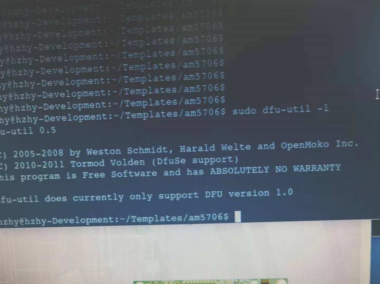

  • 1、The computer manager USB is refreshing too fast, always flashing。so there is no wait time 。Does this mean that there is a problem with the hardware?What driver do I need to install?
    2、why i plug the UART3_TXD,UART3_RXD,and gnd to PC,the power led can be lighted?
    3、in the uart boot ,there is a process is to reset the evm,i connect the resetn to gnd ,but no response。
    4、how to communicate with you directly!
    5、see pic  below ,DFU-UTIL DOES currently only support DFU verision 1.0,why?the second stage can not proceed!so i can not download the program to my custom board!

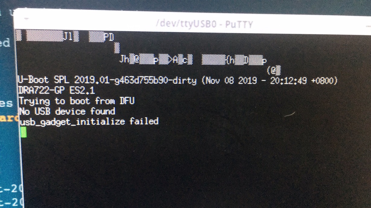

  • we use AM57x  SDK 06_01_00_08, kernel  4.19,but we get a problem .WHY? HOW TO SOLVE?
  • Hi user4973896,
    looks like you are able to get SPL loaded via USB DFU which is a good first step.
    The error you get "usb_gadget_initialize failed" points to an issue with SPL not being configured correctly for USB gadget operation.
    Did you go through the training materials Bin pointed to?
    https://training.ti.com/sites/default/files/docs/AM57x-DFU-boot-SLIDES.pdf
    One step is to enable CONFIG_SPL_DFU for U-Boot. Was this done?
    It sounds like you are working with a custom board. Do you have any DRA7/J6/AM57xx TI EVM you could try out those steps to have a known-good starting point?
    Regards, Andreas

  • Hi user4973896,
    first, have you been able to re-create a successful USB DFU U-Boot loading on a TI EVM as per the earlier suggestion?
    user4973896 said:
    Is this a problem because there is a problem with DDR?What   printing information appears shows that DDR is good?
    Are you referring to the U-Boot SPL screenshot you sent earlier? One thing that was printed there is "Trying to boot from DFU" which gets printed towards the end of SPL execution. DDR is usually setup early on during SPL execution, specifically as part of board_init_f(). The fact that you got a "Trying to boot from DFU" print means you are already well beyond DDR setup (which also gets put into use by U-Boot for global data, stack, etc.) so that means that DDR is likely not your issue.
