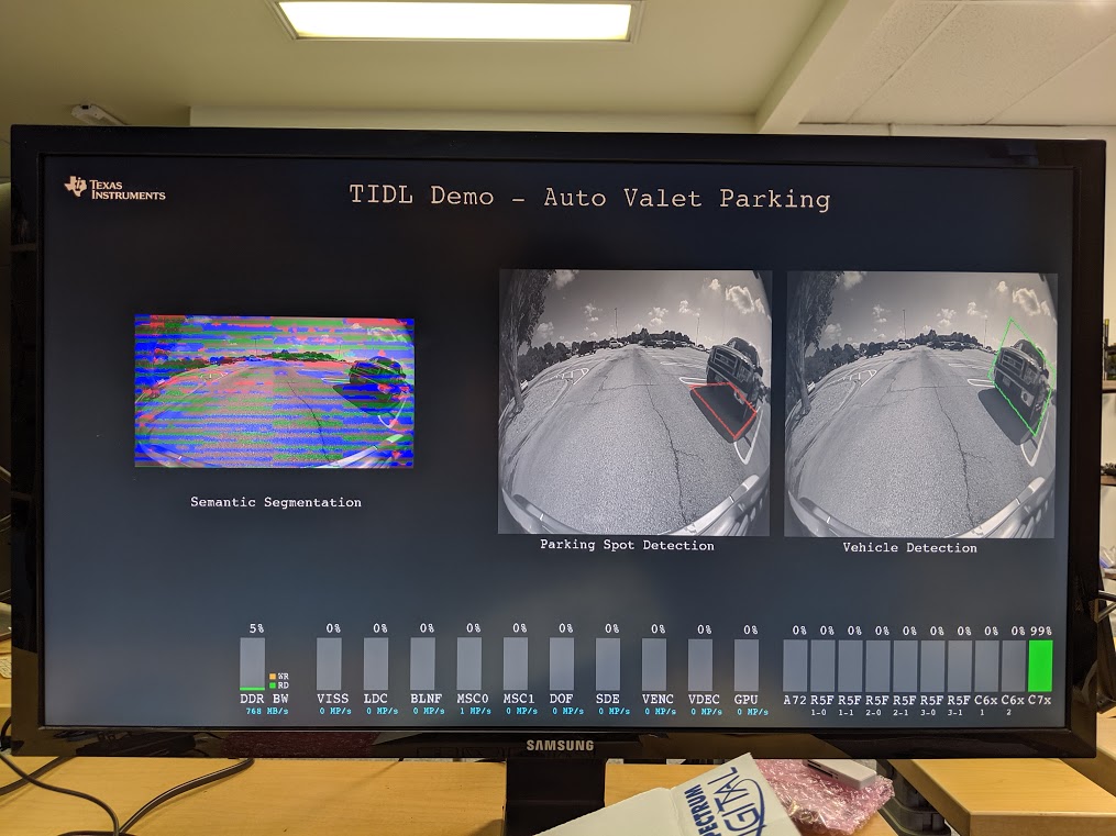

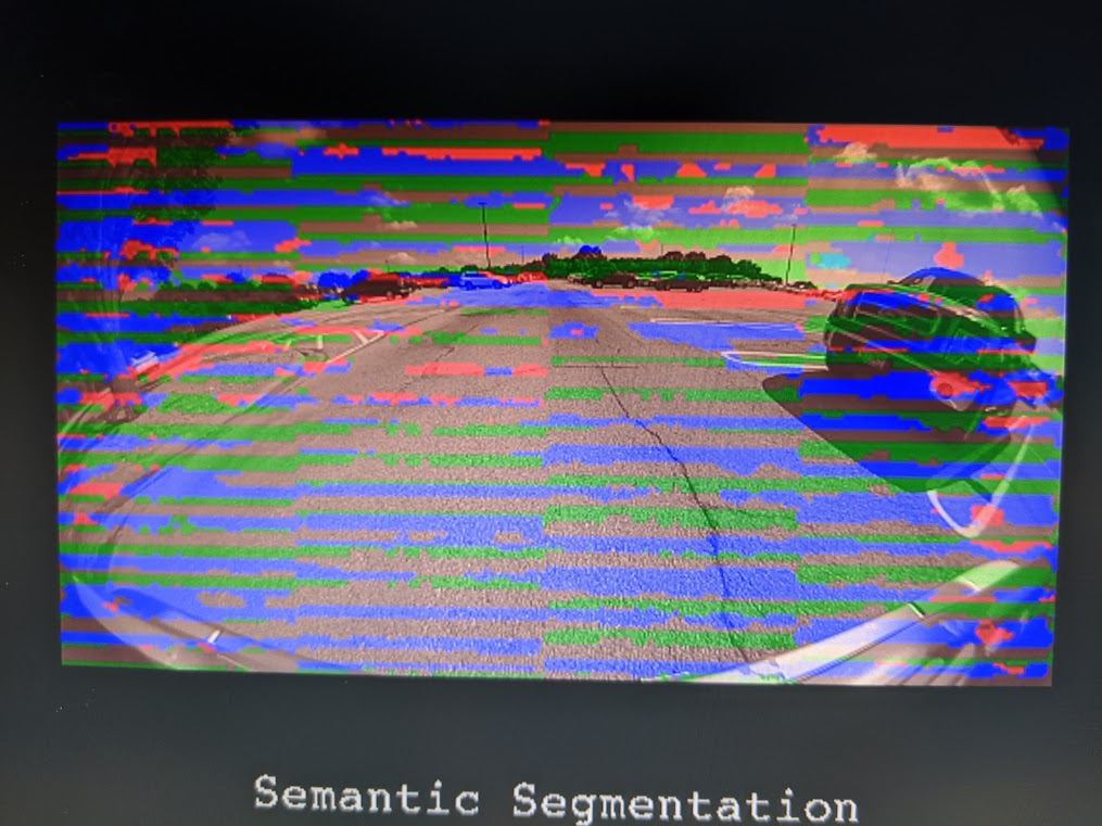

TDA4x EVM: Inception based model takes 20 minutes per frame
Hi E2E'ers
I'm trying to run a 30 layer model based on inception net for performing image segmentation. During the conversion process from caffe a performance analysis showed that the model requires about 1.6 GMACs, which does not seem like an infeasible load for the TDA4x to handle. Nonetheless, when trying to run the model on our EVM, I am finding that the TIDL openVX node is taking more than 20 minutes to push out a frame.
Our OpenVX app is based loosely on the provided AVP TIDL demo.
I'm stuck here - any ideas why this could be happening?
-Ying

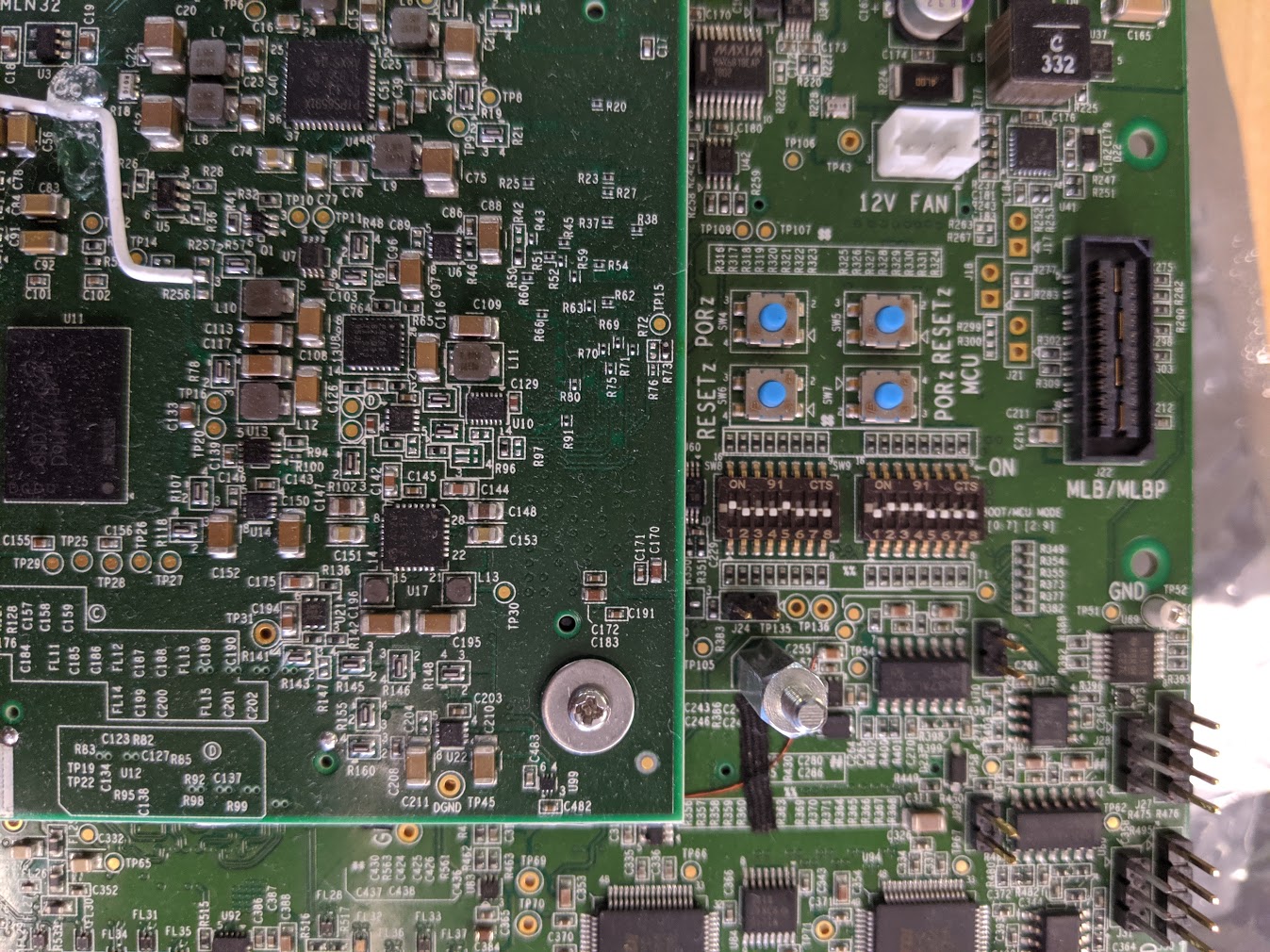

  • Hi Rishabh,
    I'm getting the following issue when trying to initialize the DSP app via JTAG:
    C71X_0: Trouble Reading Memory Block at 0x0 on Page 0 of Length 0x1: (Error -1344 - (0:0:0)) Register or Memory request has failed due to a Transaction Error. This may be the result of reading from a write only register, writing to a read only register, or accessing a memory location that is not assigned. No user action required. (Emulation package 8.3.1.00007)
    C71X_0: Trouble Reading Memory Block at 0x707e8e42 on Page 0 of Length 0x1: (Error -1350 - (0:0:0)) Register or Memory request has timed out. The CPU is executing a High Priority Interrupt, this is typically due to a Double Page Fault. Choose 'Force' to force the CPU into a state that allows debug of why the HPI is active. (Emulation package 8.3.1.00007)
    I'm using a Spectrum Digital XDS560v2 STM.

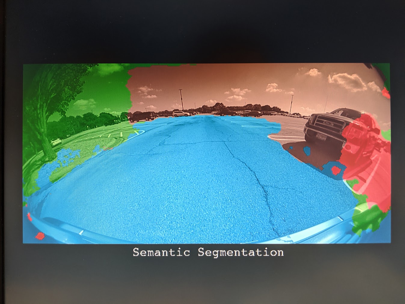

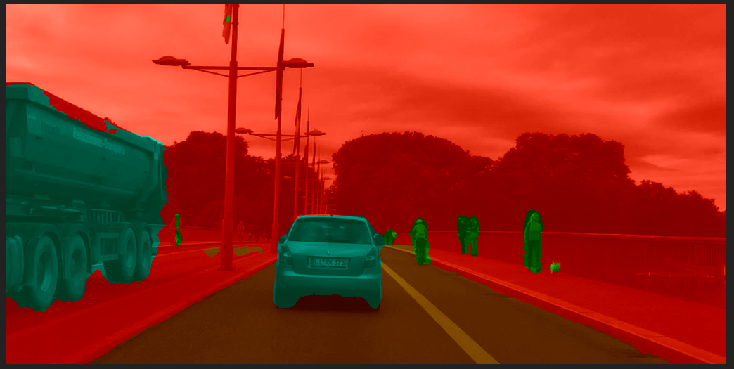

  • Also, some images showing what we're seeing. This is the first frame, which took 20 minutes to render.
    This is an image of the provided avp_tidl demo, swapping out the provided onnx model with our own. The config file was modified to point to our own converted model and the variable pc_size modified to 512 288.
    Instructions for running TIDL standalone using CCS are given here: tidl_j7_01_00_00_00/ti_dl/docs/user_guide_html/md_tidl_sample_test.html.
    I had attached the modified deploy.prototxt in thread https://e2e.ti.com/support/j721e/f/1026/t/848577 (please see reply on 6th Nov)
    Rishabh
  • Yes... those are the instructions I was following when I got the error I shared yesterday:

  • Hi Ying,
    Is your board set to NO BOOT mode?
    Rishabh
  • I believe so, here's a picture of the DIP switches:
  • Hi Ying,
    Dip switches are set correctly.
    I had installed CSP and emulator package to match the one you are using after looking at yesterday's response and it worked fine for me.
    Can you try after restarting CCS and emulator?
    Rishabh

  • Hi Rishabh,
    Excellent progress!! I've imported with your settings and was able to confirm real-time performance.
    Experimenting with the differences between our import.txt files, it looks like the "inWidth" and "inHeight" parameters are causing the severe slow-down.
    Not sure what you guys will want to do with this information, but we can probably work with this for now by using resize nodes to preprocess images into "native" inference resolution.
    Thanks so much for your patience Rishabh - much appreciated.
    -Ying

  • I have a lot of debugging left to do on my custom graph, but the TIDL node seems to be running at about 45 ms per frame (~22 fps)
