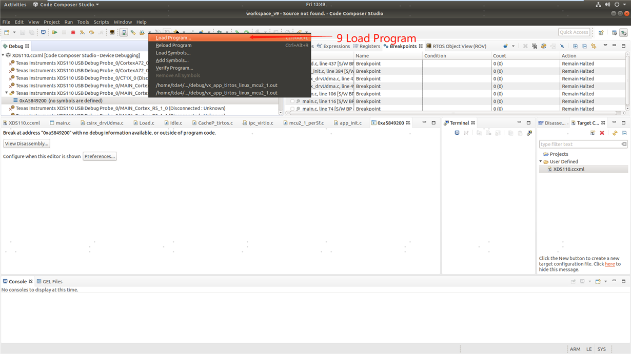

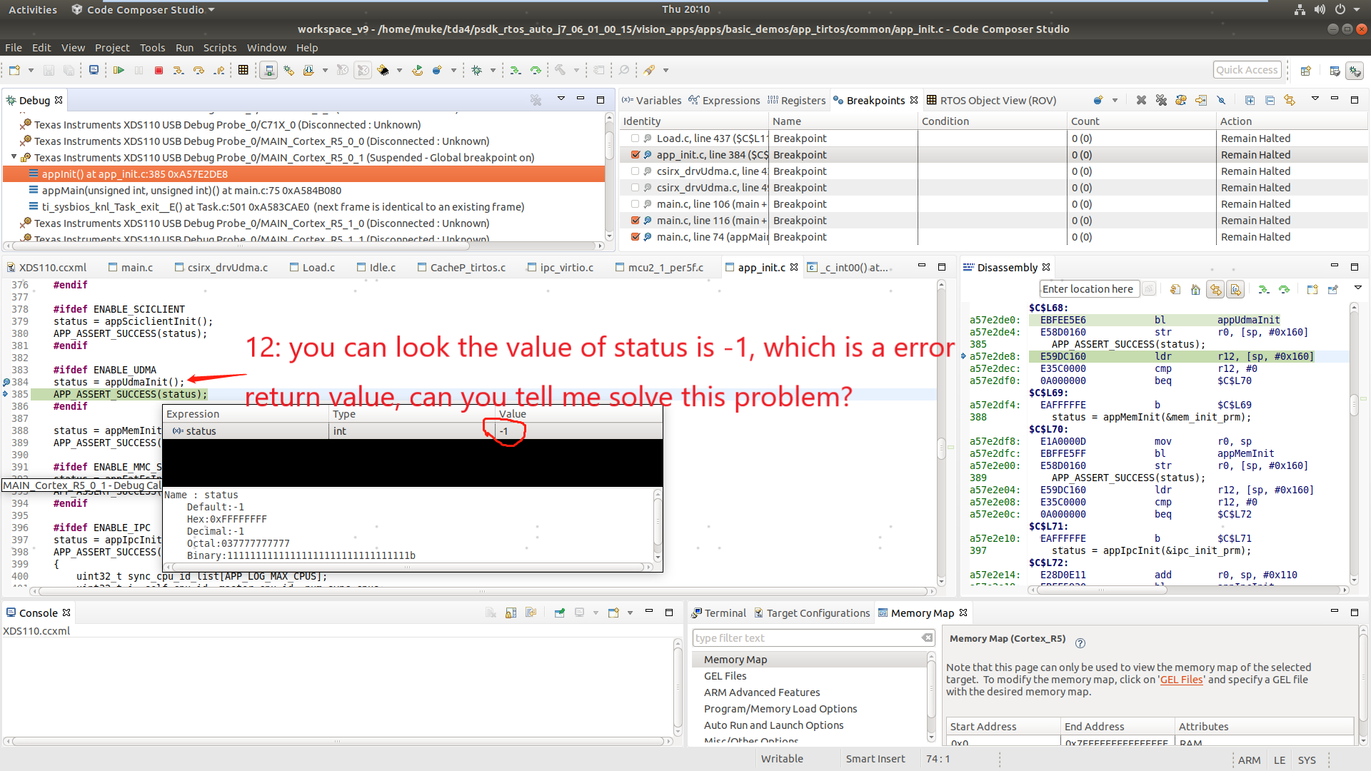

        I have a serious problem in debug,I use CCS&XDS110(TDA4 on-board debugger) debug mode, I choose to load the program, to load the(/psdk_rtos_auto_j7_06_01_00_15 / vision_apps/out/J7/R5F SYSBIOS/debug/vx_app_tirtos_linux_mcu2_1.out) files, Then I make breakpoint in the main function entry (99 lines) in (psdk_rtos_auto_j7_06_01_00_15/vision_apps/apps/basic_demos/ app_tirtos_linux/McU2_1 /main.c), Then make the breakpoint again at (psdk_rtos_auto_j7_06_01_00_15/vision_apps/apps/basic_demos/app_tirtos/common/app_init.c 384 lines) [status = appUdmaInit()], but I find that the appUdmaInit function returns -1(you can look it in pictures).
        However, if I directly control TDA4 development board through the serial port, Select the path of (/opt/vision) to run vx_app_single_cam.out, the program can be directly run, and camera can normally show images in HDMI display , so why is the return value of appUdmaInit function is -1 under debugging state? Because when the return value is -1, The debug will be stuck at code (psdk_rtos_auto_j7_06_01_00_15/vision_apps/apps/basic_demos/app_tirtos/common/app_init.c 384 lines)[APP_ASSERT_SUCCESS(status)] and cannot continue downward,this question puzzled me for a long time

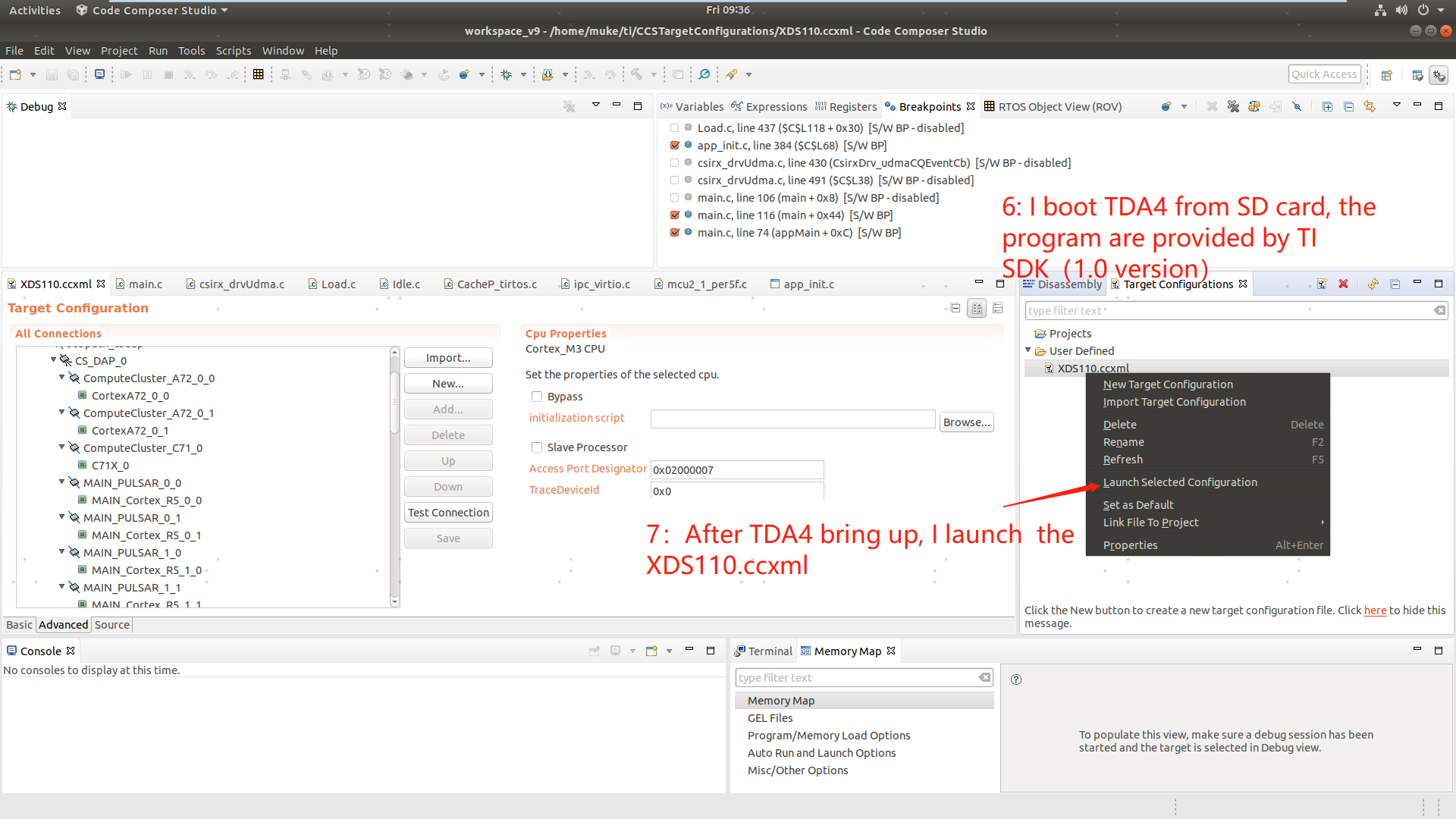

  • Hello Sivaraj
    the picture is my detailed operating procedures,can you help test the value of status and solve this problem?

  • I see two issues.
    1. As I said in my previous response, you can't just load a core's .out in CCS directly for Vision apps application. Vision apps supports only Linux uboot way of loading through SD card. If one need to debug a particular core, then one can enable the emulation flag as mentioned in the previous response.
    2. While doing the debug, you should not load the .out again. Instead you should use the "Load Symbol" option in CCS. Loading the .out again will do the core initialization again (resource reallocation happens again) and will result in failure.
