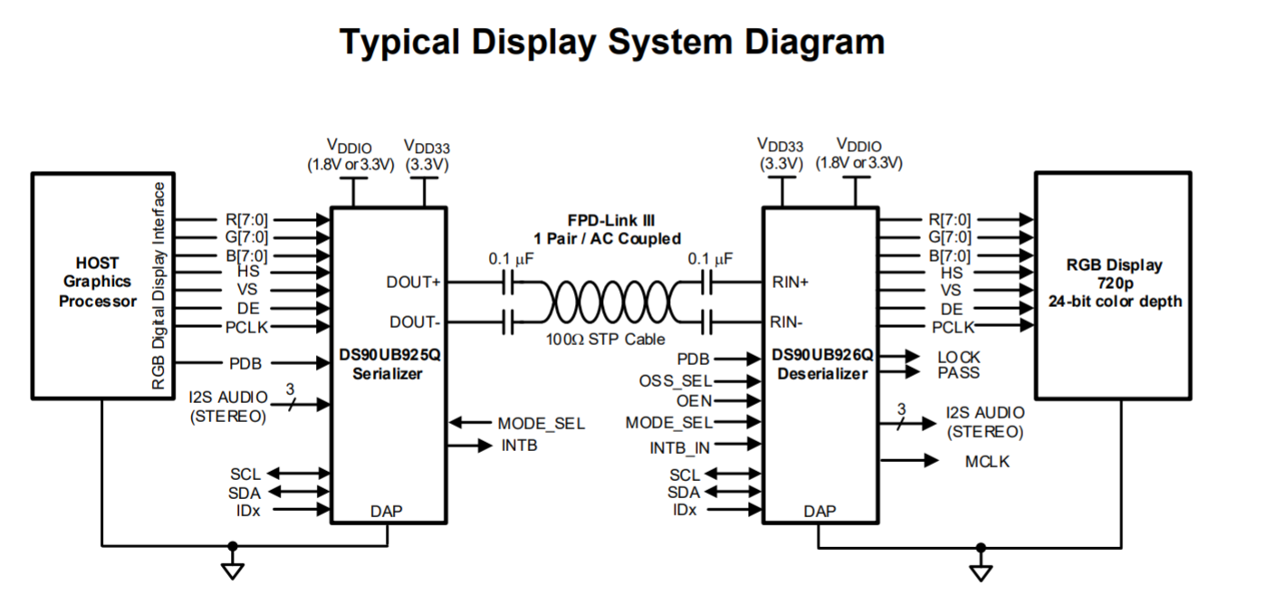

  • Alex,
    What is the specifications of the input clock your deserializer is expecting?  That will help us narrow down on the choices.  Alternatively, have you considered DS90UB926?  This deserializer offers users the opportunity to extract clock from the high speed serial stream.  A sample overview of the part is quoted below; more details can be found in the device datasheet.
    " The DS90UB926Q-Q1 deserializer attains lock to a data stream without the use of a separate reference clock source, which greatly simplifies system complexity and overall cost. The deserializer also synchronizes to the serializer regardless of the data pattern, delivering true automatic plug and lock performance. It can lock to the incoming serial stream without the need of special training patterns or sync characters. The deserializer recovers the clock and data by extracting the embedded clock information, validating then deserializing the incoming data stream. "
    Have a great day!
    Shiou Mei
