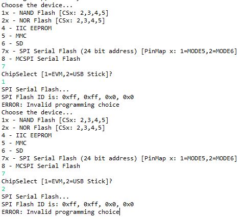

I'm using C5545 on my own board with 24 bit SPI serial flash eeprom to boot device.
But, I have some problem.
When I selected SPI Serial Flash, what is meaning of MODE 5 or MODE 6?
and
after I chose SPI Serial Flash,  I got this message. What is my problem??

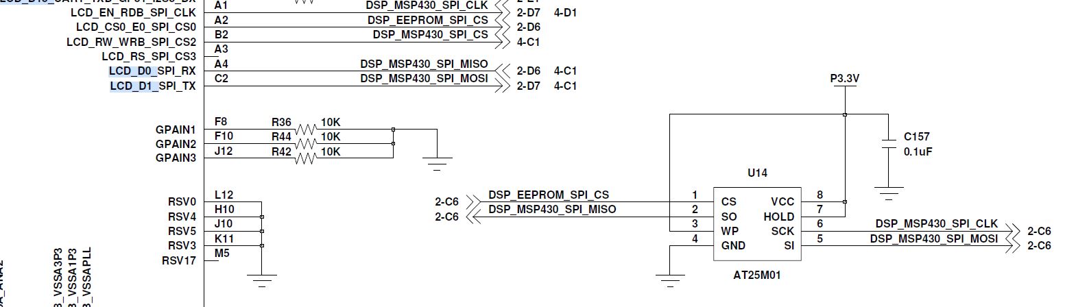

And This is part of schematic. I'm using C5545 on my own board. Is there some problem??
Thank you for the reading and please give me some details.
    First of all, check if you comply with Section 2.2.2 24-Bit SPI Serial Flash from the Bootloader appnote:
       https://www.ti.com/lit/an/sprabl7d/sprabl7d.pdf
    Most important make sure you match with Figure1. C5535SPI Flash Boot Waveform.
    Then the error says "Invalid programming choice", have you tried selecting option 8 - McSPI Serial Flash? From your screenshot I see options 1, 2 and 7 are marked with an "x", which I suppose means they are unsupported for the device/software.

    I checked the spi wave when I program project (CSL_example / programmer )
    But just CS pin changed low to high when I choose 7 2.
    SCK, MISO , MOSI are not changed.
    Also when I choose 8 , It said " Invalid progamming choice"
    I already read sprabl7d.pdf and there, I could use SPI eeprom 24bit. right?
    why there is no signal in SPI ?
    Could you give me some details or my mistake?
    Thank you
    Correct. But note that the SPI serial flash must comply with all the recommendations listed in Section 2.2.224-BitSPI Serial Flash in the document.
    For more details on the boot procedure see the device Datasheet, Section 6.4 Boot Sequence, it describes in detail the SPI Flash boot.
    Yordan
