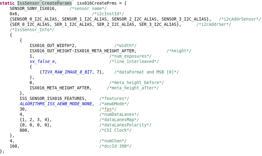

  • Please try 8b RAW format with MSB = 7, as we discussed on the call.
  • Hi Mayank,
    I did try that option, but the create graph failed, i am trying to understand the cause behind it. I will keep you posted once i debug that.

    I tried  the following deserializer settings.
    In continuation with the above experiments, i connected 2 cameras to Sensor Fusion Board (Cam0 port and Cam3 port) thinking that the 0x4C register is trying to read the PORT3 according to my code. After that i am able to dump raw images.
    My settings are as follows:
                    {TIVX_RAW_IMAGE_16_BIT, 11},    /*dataFormat and MSB [0]*/
    My configuration for deserializer is as follows:
        {0x4C, 0x38, 0x10},
        {0x58, 0x58, 0x10},
        {0xD5, 0xF0, 0x10},
        {0x6D, 0x6D, 0x10},
        {0x70, 0xEB, 0x10},
        {0x71, 0xEC, 0x10},
        {0x5D, (BSPUTILS_SER_ID_ADDR << 1U), 0x10}, /*Serializer I2C Address*/

  • It seems like a mismatch between sensor output format and CSI Rx capture format. Can you please go through the sensor datasheet and confirm the exact format of the data sensor is sending?
  • Hi Mayank,
    According to the Sensor Datasheet, Digital Image data consists of 8-bit luminanace signal (Y) and 8-bit chrominance signal (UV)
    I have shared more details over email.
    Anshuman
  • Please try
    {TIVX_RAW_IMAGE_8_BIT, 7 },
    You will need to double the image width.
  • Hi Kumar,
    Just want to know, why you are tagging input YUV422 as 12bit RAW. It should be tagged as YUV422 and even in the capture modules, you need to capture as vx_image, not as raw_image..
    Since you are already able to capture, it looks like you are missing some bits. Can you try putting data type to YUV422 in deserializer and using vx_image in capture node?

  • Hi Mayank,
    After making the following changes, {TIVX_RAW_IMAGE_8_BIT, 7 },  and ISX016_OUT_WIDTH*2 in IssSensor_CreateParams structure, the capture node creation is failing.
    Please find the error logs:
