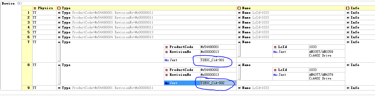

I want to realize cia402 on AM3359.I have generated the ethercat_slave_full project and redfined the "ecat_def.h".The project ran well on AM3359ICE board.But why the program displayed on TwinCAT is the program of AM437x.It shows TIESC_CiA-002.The xml file said TIESC_CiA-002 should run on AM437x.TIESC_CiA-001 is used AM3359.Even if I chenged all the "ProductCode" to"54490001",it still does not work.There are a few pictures and the "ecat_def.h".
