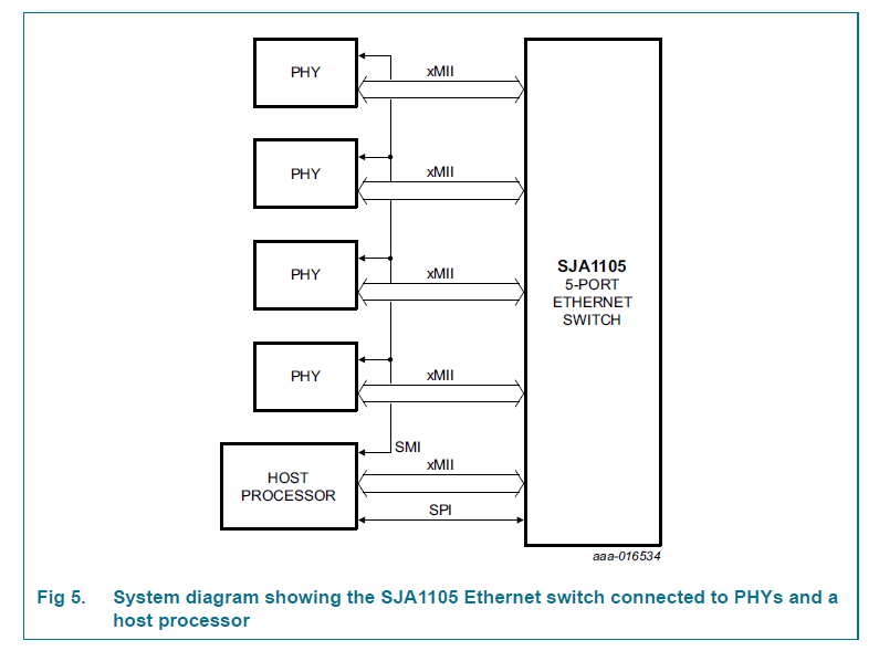

    1、SJA1105 is connected as follows:
    2、The host here USES a controller, and the connection mode is:
    3、Then, 3 PHY are used in 4 PHY, and the other one is not PHY but RGMII of TDA2P. May I ask which of the following is the connection method of TDA2P?
    4、Another question is: where MDC and MDIO of host are input to three PHY, how to connect MDC and MDIO of TDA2P?Is there a connection, and if so, how?

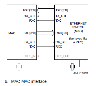

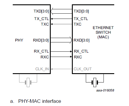

  • Hi Neal,
    1. TDA2x cannot act as PHY. It needs to be MAC-MAC mode of the switch, i.e the 4th port, should be configured as MAC-MAC mode which will be connected to TDA2x.
    2. MDIO is not required in this case. SPI communication needs to be used for this Switch SJA1105, to configure.

  • Hi Neal,
    What is 'host' and how is it different from TDA2p ? Do you have any block diagram or schematics snippet to show your connection ?
    Host is main, it's TDA2P-ACD,thanks!
  • Hi Neal,
    So host is same as TDA2xp. In that case, TDA2xp would be SPI master and Ethernet switch would be the slave. Please close this issue if it has answered your queries.
    sorry, SJA1105 and TDA2P as SPI slave, host is tc277, Can TDA2P control SJI1105?
    If TDA2p is configured as SPI slave, it cannot directly control SJA1105. Whether SPI configurations are one time programming(at boot time) or need to change dynamically(for every ethernet settings from TDA2p or configuration change), you need to check with NXP, since the document on SJA1105 is not elaborate.
