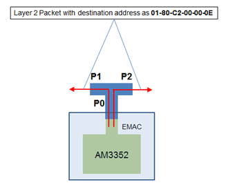

    I am using ioctl mentioned in Link CPSW section of SW developer guide to configure CPSW.
    Let me explain my requirement with below diagram:
    1> All incoming Layer 2 packet with destination address as 01-80-C2-00-00-0E (LLDP multicast address) should be forwarded to Port 0(Host Port).
    2> Layer 2 packet with destination address as 01-80-C2-00-00-0E(LLDP multicast address) received on Port 0 (Host port) should get forwarded to Port 1 and Port 2.
    Query:
    Can I configure CPSW to achieve both scenario as shown above?
    I do not want to change CPSW configuration at run time to achieve each scenario at a time. I want to configure CPSW once and It should behave as shown in above two case.
    Rohit Savaliya
    I apologize for the delay in responding. You should be able to configure the switch per your diagrams.
