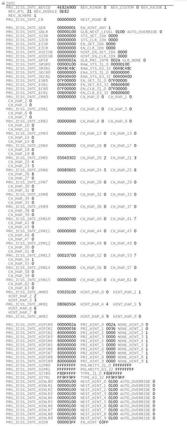

I have ported the PRU-ICSS-EthernetIP-Adapter and the ICSS_EMAC to our existing product platform (CPU: AM4376, RTOS: Nucleus-Plus). Now, I try to adapt the NIMU_ICSS to our networking stack (Nucleus-NET). Initialization of the PRUs, EIP-Adapter and ICSS_EMAC is done, link can be established and I get link interrupts (ICSS_EmacLinkISR) for both Ethernet ports. But Rx interrupts are completely missing.
The interrupt mapping is used from the EIP example (tiswitch_pruss_intc_mapping.h):
PRU EVENT => CHANNEL => HOST INT => INT NUM (ISR)
42 => 0 => PRU0 internal
54 => 1 => PRU1 internal
20 => 2 => PRU_ICSS_EVTOUT0 => 52 (ICSS_EmacRxInterruptHandler)
Having a look at the INTC registers of ICSS_1 I can see that HIPIRX set as follows:
HIPIR0 = 0x0000002A (PRU event 42)
HIPIR1 = 0x00000036 (PRU event 54)
HIPIR2 = 0x80000000 (no event pending)
All host interrupts are enabled (HIER = 0x000003FF).
I would expect that the value of HIPIR2 should be 0x00000014 and interrupt number 52 is being issued.
What might be the reason for this behavior?

    while trying to identify the reasong for the missing interrupts I had a closer look at ICSSSwitchConfig in iscc_emacFwInit.c. I tried to understand the buffer and queue setup but could not find any documentation for the descriptor composition.
    So I tried to understand the descriptor setup from what is written into the data RAM.  For example, the tx context setup for port 1 contains the following descriptor for queue 1:
    Address Value
    0x54403D00 0x6D006100
    0x54403D04 0x11A01020
    I assume this means, that tx buffers for queue 1 of port 1 start at offset 0x6100 and ends at offset 0x6D00 in (L3 OCMC RAM). Further, the tx buffers for queue 1 of port 1 start at offset 0x10020 and end at offset 0x11A0. This seems to be identical for all tx queues of port 1 and 2.
    When looing at the rx buffers of the host port 3, the rx context setup seems to follow a different mapping. Example for rx context of host port and queue 1:
    Address Value
    0x54403D50 0x1E7C0000
    0x54403D54 0x07040400
    Here, the offset of the last buffer (0x1E7C) seems to be wrong. The host queue has 194 buffers with each 32 bytes. So I would expect that the last buffer should be at 0x1820.
    Ist this correct or are the rx buffer descriptors set up in a different way?
    Best regards
    Stefan

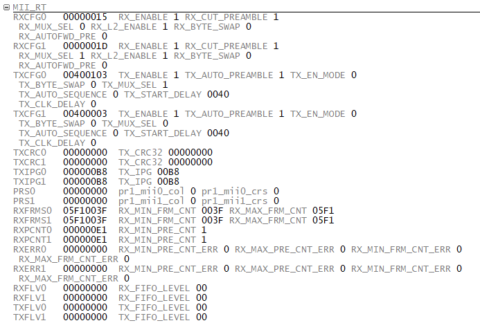

    For Rx interrupt issue, have you checked the RXCFG and RXERR registers of ICSS MII RT? Also, make sure the pinmux is configured properly.
    For rx buffers descriptors setup, you may step into the ICSSSwitchConfig() to deduce how 0x1E7C0000 is set.
    Garrett
  • Hello Garrett,
    thank you for your reply.
    MII_RT registers
    I have checked the MII_RT register an could not find any pending receive errors. The configuration looks OK to me:
    MII_RT.RXCFG0 = 0x00000015 (MUX = port 0, RX enabled, preamble cut off)
    MII_RT.RXCFG1 = 0x0000001D (MUX = port 1, RX enabled, preamble cut off)
    MII_RT.RXERR0/1 = 0 (no errors)
    The MII_RT configuration registers are set by the ICSS_EMAC. I attatched a screenshot of the complete MII_RT register set.

    ICSS-EMAC configuration
    Another weird poit ist the priority queue selection in the ICSS_EMAC configuration. In the ethernetip_adapter example, priority queue is set to ICSS_EMAC_QUEUE3 (queue index = 2). In the ICSS_EIP_Adapter_Developer_Guide it looks like queue index 3 (ICSS_EMAC_QUEUE4) is dedicated to TCP/IP communication. I guess, the queue selection has nothing to do with the muissing receive interrupts. Which queue has to be selected as priority queue for the ICSS_EMAC?
    FURTHER OVSERVATIONS
    • After the PRU0/1 registers are configured by ICSS_EmacInit the PRU0/1 firmware (v1.0 or v2.1) is loaded and enabled. Host interrrupts are enabled and cleared, too. The PRU0/1 fimrmware is running (RUNSTATE = 1, PCTRR = counting). I attatched a screenshot of the complete PRU0/1_CTRL register set.
    • The interrupt PRU => Host mapping (INTC) looks OK to me. Link interrupts are successfully genereated for link up/down events on both ports, all host interrupts are enabled (PRU_ICSS_INTC_HIER = 0x3FF), all system events (20..26, 41, 42, 53, 54) are enabled (PRU_ICSS_INTC_ESR0/1).
    • I can see pending receive events PRU_ICSS_INTC_HIPIR0 (event 42) and PRU_ICSS_INTC_HIPIR1 (event 54). Having a look at the L3 OCMC RAM I can also see receive frames that have been copied from the Ethernet bus to the Rx Context buffers at offset 0x48C0 (Queue 4). So it seems to me that the firmware has received frames, copied them to L3 but does not issue system event 20 (PRU_ICSS_INTC_HIPIR2 = 0x80000000).

  • Hi Stefan,
    Have you also tried to dump and compare the INTC registers with default TI RTOS application which might give some clue? The system event 20 really should happen if the frames have been copied to L3 as there is no any mod on PRU firmware while you port the host application from TI RTOS to Nucleus RTOS.
    Is it possible to run the loopback unit test (ICSS_EMAC_BasicExample_idkAM437x_wSoCFile_armtestproject) of icss_emac driver from PDK on your board?
    Garrett
  • Hello Garrett,
    No, I haven't done that, yet. Our idk437x hardware is currently not available. I just took the INTC configuration from "examples/ethernetip_arapter/tiswitch_pruss_intc_mapping.h" and let the ICSS_EMAC do the configuration. As far as I have seen, all examples do it in the same way.
    I have checked the INTC configuration multiple times and could not find any issue. I get link interrupts for both ports and I can manually issue event 20 by writing 0x00100000 into PRU_ICSS_NTC_SRSR0 and the host interrupt is gegerated sucessfully. Therefore, I assume that the INTC confogiration must be correct for link and RX interrupts.
    • What about the register mapping I have provided (screenshots)? Could you see any problematic settings?
    • In the PRU_ICSS_INTC_HOHIR0/1 register, events 42 and 54 keep on pending after they appeared the first time. I would expect, that the PRU will clear them after issuing event 20. Is this correct? May this be a hint?

  • Stefan,
    Except the SRSR0, SECR0 and HIPIR2, other register mappings looks OK. Please find the attached register dump when ICSS_EmacRxInterruptHandler is hit:
    521177 32

    R PRU_ICSS_MII_RT_RXCFG0 0x0000000B 0x00000015
    R PRU_ICSS_MII_RT_RXCFG1 0x0000000B 0x0000001D
    R PRU_ICSS_MII_RT_TXCFG0 0x0000000B 0x00400103
    R PRU_ICSS_MII_RT_TXCFG1 0x0000000B 0x00400003
    R PRU_ICSS_MII_RT_TXCRC0 0x0000000B 0xA301FA13
    R PRU_ICSS_MII_RT_TXCRC1 0x0000000B 0x00000000

    For the event status clear, see the description of SECR0 Register:
    The System Event Status Enabled/Clear Register0 show the pending enabled status of the system events
    0 to 31. Software can write to the Status Clear Registers to clear a system event after it has been
    serviced. If a system event status is not cleared then another host interrupt may not be triggered or
    another host interrupt may be triggered incorrectly.
    The register dump aligns with the description when the ISR doesn't happen:
    521177 32
    R PRU_ICSS1_INTC_PRU_ICSS_INTC_REVID 0x0000000B 0x4E82A900
    R PRU_ICSS1_INTC_PRU_ICSS_INTC_CR 0x0000000B 0x00000000
    R PRU_ICSS1_INTC_PRU_ICSS_INTC_GER 0x0000000B 0x00000001
    R PRU_ICSS1_INTC_PRU_ICSS_INTC_GNLR 0x0000000B 0x00000100
    R PRU_ICSS1_INTC_PRU_ICSS_INTC_SISR 0x0000000B 0x00000000
    R PRU_ICSS1_INTC_PRU_ICSS_INTC_SICR 0x0000000B 0x00000000
    R PRU_ICSS1_INTC_PRU_ICSS_INTC_EISR 0x0000000B 0x00000000
    R PRU_ICSS1_INTC_PRU_ICSS_INTC_EICR 0x0000000B 0x00000000
    R PRU_ICSS1_INTC_PRU_ICSS_INTC_HIEISR 0x0000000B 0x00000000
    R PRU_ICSS1_INTC_PRU_ICSS_INTC_HIDISR 0x0000000B 0x00000000
    R PRU_ICSS1_INTC_PRU_ICSS_INTC_GPIR 0x0000000B 0x0000002A
    R PRU_ICSS1_INTC_PRU_ICSS_INTC_SRSR0 0x0000000B 0x00004180
    R PRU_ICSS1_INTC_PRU_ICSS_INTC_SRSR1 0x0000000B 0x0000040C
    R PRU_ICSS1_INTC_PRU_ICSS_INTC_SECR0 0x0000000B 0x00000000
    R PRU_ICSS1_INTC_PRU_ICSS_INTC_SECR1 0x0000000B 0x00000400
    R PRU_ICSS1_INTC_PRU_ICSS_INTC_ESR0 0x0000000B 0x07F00000
    R PRU_ICSS1_INTC_PRU_ICSS_INTC_ESR1 0x0000000B 0x00600600
    R PRU_ICSS1_INTC_PRU_ICSS_INTC_ECR0 0x0000000B 0x07F00000
    R PRU_ICSS_MII_RT_TXIPG0 0x0000000B 0x000000B8
    R PRU_ICSS_MII_RT_TXIPG1 0x0000000B 0x000000B8
    R PRU_ICSS_MII_RT_PRS0 0x0000000B 0x00000000
    R PRU_ICSS_MII_RT_PRS1 0x0000000B 0x00000000
    R PRU_ICSS_MII_RT_RXFRMS0 0x0000000B 0x05F1003F
    R PRU_ICSS_MII_RT_RXFRMS1 0x0000000B 0x05F1003F
    R PRU_ICSS_MII_RT_RXPCNT0 0x0000000B 0x000000E1
    R PRU_ICSS_MII_RT_RXPCNT1 0x0000000B 0x000000E1
    R PRU_ICSS_MII_RT_RXERR0 0x0000000B 0x00000000
    R PRU_ICSS_MII_RT_RXERR1 0x0000000B 0x00000000
    R PRU_ICSS_MII_RT_RXFLV0 0x0000000B 0x00000000
    R PRU_ICSS_MII_RT_RXFLV1 0x0000000B 0x00000000
    R PRU_ICSS_MII_RT_TXFLV0 0x0000000B 0x00000000
    R PRU_ICSS_MII_RT_TXFLV1 0x0000000B 0x00000000

    >>> Except the SRSR0, SECR0 and HIPIR2, other register mappings looks OK. Please find the attached register dump when ICSS_EmacRxInterruptHandler is hit: eip_pru_reg.txt (...)
    • I agree that the register dumps are looking equal except the SRSR0, SECR0 and HIPIR2. But your PRU1 seems to be in software reset (PRU_ICSS1_PRU1_CTRL = 0x00000001 ?!).
    • The behavior of my SECR0 register also corresponds to the description: If event 20 is not issued, SECR0 is = 0x00000000, if event 20 is issued manually, SECR0 is = 0x00100000. But the original issue is still the same: The PRU does not issue event 20 automatically.
