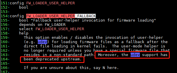

Dear TI,
I am now working with our TDA2x custom board. The visionSDK revision i used is 3.06.
The rootfs i used is a minimal filesystem compiled by YOCTO projec.
This is the kernel startup log:

  • Hi Angela,
    I have tried your suggestion that enable the
    CONFIG_FW_LOADER_USER_HELPER=y  and
    CONFIG_FW_LOADER_USER_HELPER_FALLBACK=y
    while build the remoteproc into the kernel zImage.
    But still i cannot get the firmwares loaded.

    [    2.044474] omap-rproc 58820000.ipu: assigned reserved memory node ipu1_cma@9d000000
    [    2.052325]  remoteproc0: 58820000.ipu is available
    [    2.057242]  remoteproc0: Note: remoteproc is still under development and considered experimental.
    [    2.066242]  remoteproc0: THE BINARY FORMAT IS NOT YET FINALIZED, and backward compatibility isn't yet guaranteed.
    [    2.076751]  remoteproc0: Direct firmware load for dra7-ipu1-fw.xem4 failed with error -2
    [    2.079588] mmc0: MAN_BKOPS_EN bit is not set
    [    2.085038] mmc0: new HS200 MMC card at address 0001
    [    2.094478] omap-rproc 55020000.ipu: assigned reserved memory node ipu2_cma@95800000
    [    2.095529] mmcblk0: mmc0:0001 008GB0 7.28 GiB
    [    2.105788] mmcblk0boot0: mmc0:0001 008GB0 partition 1 8.00 MiB
    [    2.112799]  remoteproc0: Falling back to user helper
    [    2.116060] mmcblk0boot1: mmc0:0001 008GB0 partition 2 8.00 MiB
    [    2.116370]  remoteproc1: 55020000.ipu is available
    [    2.116374]  remoteproc1: Note: remoteproc is still under development and considered experimental.
    [    2.116377]  remoteproc1: THE BINARY FORMAT IS NOT YET FINALIZED, and backward compatibility isn't yet guaranteed.
    [    2.116500]  remoteproc1: Direct firmware load for dra7-ipu2-fw.xem4 failed with error -2
    [    2.116503]  remoteproc1: Falling back to user helper
    [    2.116765] omap-rproc 40800000.dsp: assigned reserved memory node dsp1_cma@99000000
    [    2.116813]  remoteproc2: 40800000.dsp is available
    [    2.116816]  remoteproc2: Note: remoteproc is still under development and considered experimental.
    [    2.116819]  remoteproc2: THE BINARY FORMAT IS NOT YET FINALIZED, and backward compatibility isn't yet guaranteed.
    [    2.117195] omap-rproc 41000000.dsp: assigned reserved memory node dsp2_cma@9f000000
    [    2.117241]  remoteproc3: 41000000.dsp is available
    [    2.117245]  remoteproc3: Note: remoteproc is still under development and considered experimental.
    [    2.117248]  remoteproc3: THE BINARY FORMAT IS NOT YET FINALIZED, and backward compatibility isn't yet guaranteed.
    [    2.119941]  mmcblk0: p1 p2
    [    2.121709] evm_3v3_sw: supplied by sysen1
    [    2.131912]  remoteproc2: Direct firmware load for dra7-dsp1-fw.xe66 failed with error -2
    [    2.131916]  remoteproc2: Falling back to user helper
    [    2.142170]  remoteproc3: Direct firmware load for dra7-dsp2-fw.xe66 failed with error -2
    [    2.142173]  remoteproc3: Falling back to user helper

    And also, i noticed the comment under config FW_LOADER_USER_HELPER_FALLBACK says:
    I don't know what does that exactly mean. Does it say that the udev service don't support load firmware now?
    Liu Gan
  • Hi Liu Gan,
    The recommended way is to use remoteproc as a module rather than as built-in because it won't be able to request the firmware until FS init. Is module loading still working fine for you?
    Angela
  • Hi Angela,
    Yes, the remoteproc module is still working fine.
    I am studing the possibility build the remoteproc into the kernel image. Never mind.
    Liu Gan
