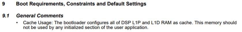

    At first glance, I’m not sure it’s possible to place code into L1P RAM as the bootloader configures it as cache by default. Snippet from Using the TMS320C6748/C6746/C6742 Bootloader:
    There may be a way to copy the code into L1P at run-time using the DMA. I will discuss this with our boot expert and follow-up soon.

  •  Sahin,
    Customer does use the built-in bootloader ROM to load the AIS formatted UBL from flash.  The UBL then loads the software into RAM using the TI-provided SBL_MulticoreImageParse() Function.
    It sounds like the customer could have the UBL reconfigure the cache as RAM prior to the copy if they want to use it.  It looks like this can be done either with the CSL functions CACHE_L1pSetSize()/CACHE_L1dSetSize() or by directly setting and reading back the L1PCFG/L1DCFG registers.

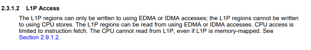

  • Lawrence,
    Please make sure they are using EDMA/IDMA to read/write to L1P. The CPU cannot access L1P as indicated in the TMS320C674x DSP Megamodule Reference Guide.
    I checked with the design team regarding what could be causing the device to reset after executing code in L1P. This was their reply:
    "Can you check if they are seeing any ECC interrupts from L1P. That could happen if they are pre-fetching code beyond the last instruction. They can pad their code with NOPs to get around that."
