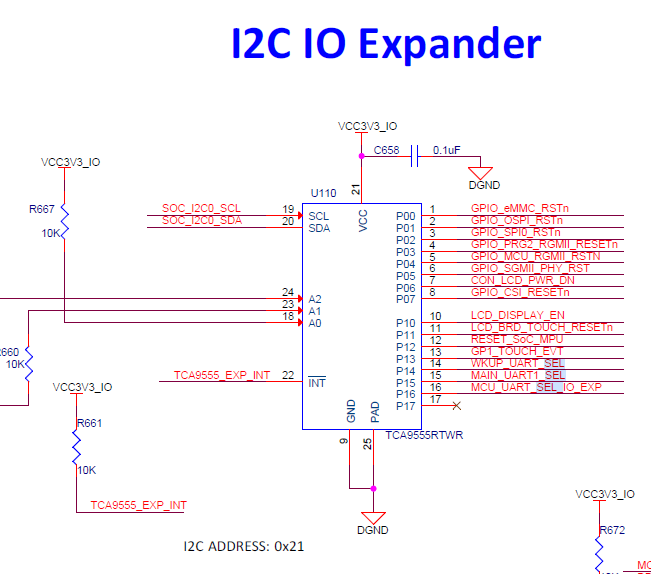

My other question, is that the IO expansion header which controls the LED's which I am currently testing, is of type TPIC2810D, which only has 8 pins, wereas the IO expansion header on which the MCU_UART_SEL pin is located, is of type TCA9555RTWR and has 16 pins:
Are there driver API's available for the TCA9555RTWR? Can the API's that are used on the TPIC2810 be used on it, and if so, how? Otherwise I guess I would manually have to go and develop driver API's for this IO expansion header in order to program the select pins.

    Some of the APIs I still experience issues with, however that was only associated with the TPIC2810 LED driver chip. I thus think that these exact APIs were not developed for this chip, although some APIs can still be used successfully. I have successfully used it on the TCA9555 chip. I believe the issues with the API used with the LED driver chip is the incorrect reading and writing from and to the data shift register.
