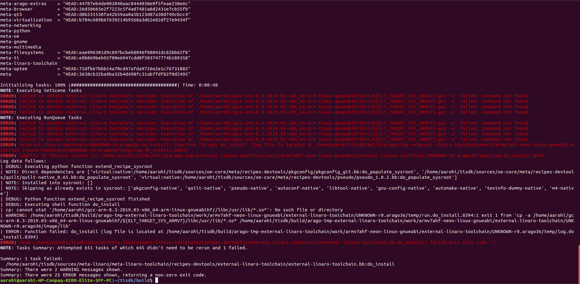

hello i'm following
1.2. Building the SDk
software-dl.ti.com/.../Overview_Building_the_SDK.html
for building processor sdk
but getting such error
Part Number: AM3358
hello i'm following

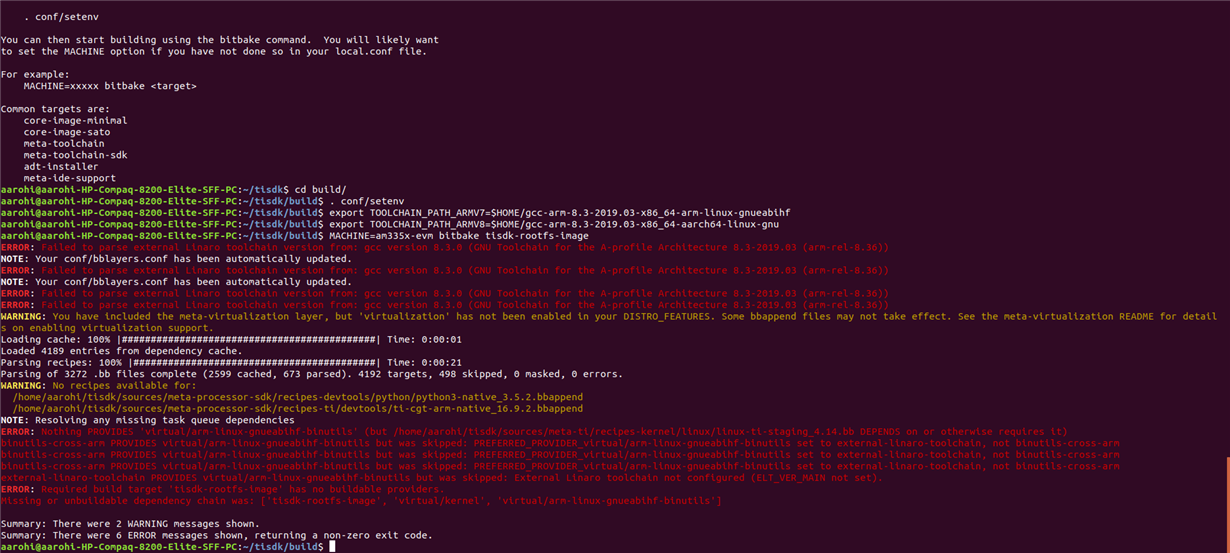

Hello RAJU,
The exported toolchain version you use, doesn't match the initialized processor-sdk-05.02.00.10-config.txt file. For processor-sdk-05.02.00.10-config.txt you need to export toolchain version gcc-linaro-7.2.1-2017.11-x86_64_arm-linux-gnueabihf.
$ wget https://releases.linaro.org/components/toolchain/binaries/7.2-2017.11/arm-linux-gnueabihf/gcc-linaro-7.2.1-2017.11-x86_64_arm-linux-gnueabihf.tar.xz
$ tar -Jxvf gcc-linaro-7.2.1-2017.11-x86_64_arm-linux-gnueabihf.tar.xz -C $HOME
$ export TOOLCHAIN_PATH_ARMV7=$HOME/gcc-linaro-7.2.1-2017.11-x86_64_arm-linux-gnueabihf
Kemal
yup its work
Thank you so much #Kemal R. Shakir for such a great assistance.
