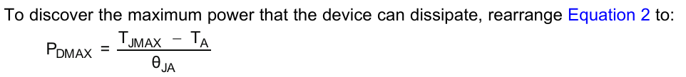

    4) In the calculation of Pd_max (maximum power that the device can dissipate), what should be the value of Theta_ja? The equation is shown below from the "Understanding thermal dissipation and design of heatsink" document.

    4.  This Theta_JA is the true thermal resistance from the junction to ambient considering all thermal paths.
