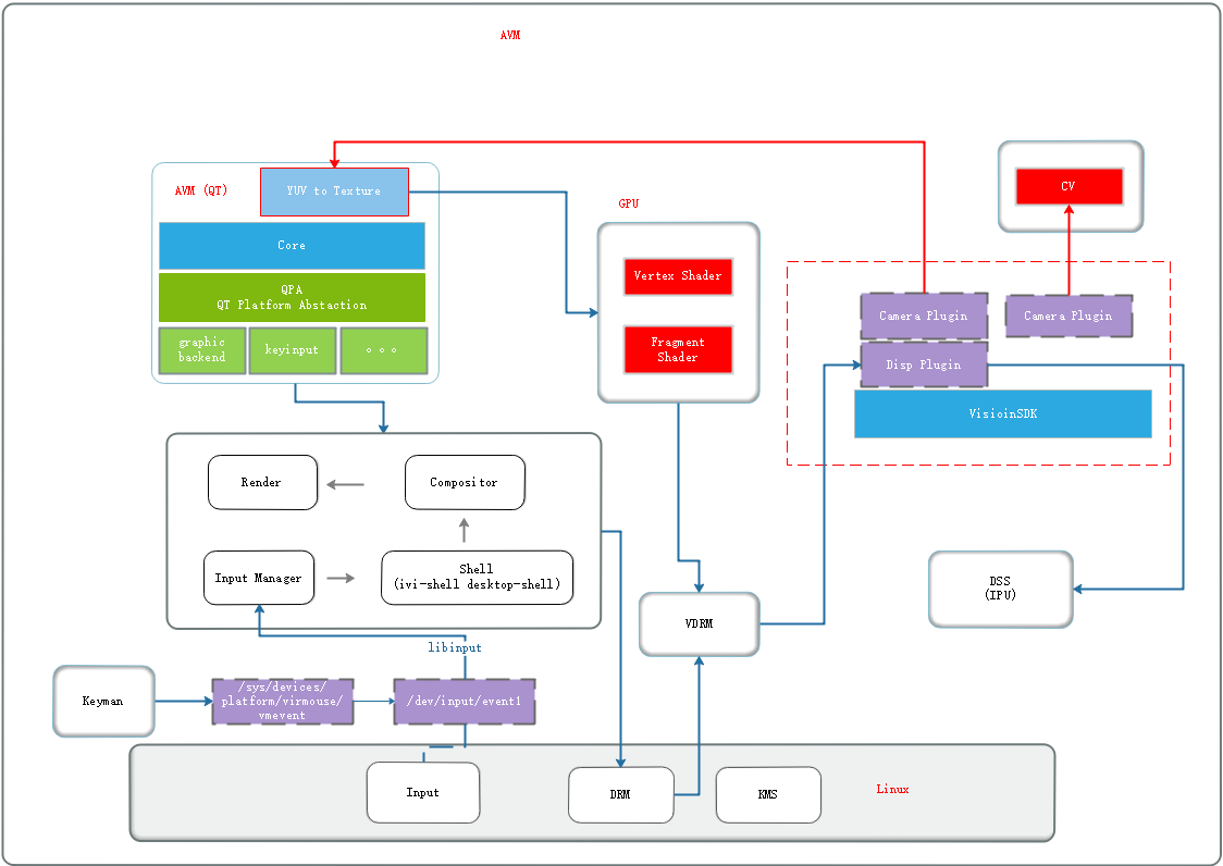

We are using Vision SDK and Virtual DRM together.
The VSDK version is 03.05.00.00.
We porting QT to VSDK linux rootfs.
1. Vision SDK is to capture camera data and manage display.
2. GPU to do stitching and QT to draw the AVM diagram.
we met the problem as below.
PVR_K:(Error): SGXOSTimer() detected SGX lockup
Here is the full chart.
for the detail of the blue rectangle "VisionSDK" on the right-upper side, please see below chart.

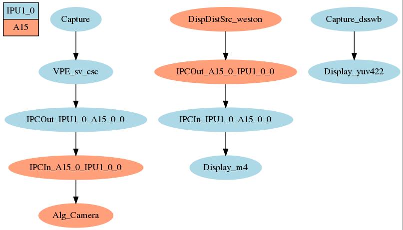

we have done below tests:
1. remove VPE_sv_csc link, system not crash.
2. remove Capture_dsswb and Display_yuv422 link, system not crash.
Customer will try to test below case, then update to ticket.
3. comment AVM function, check if system crash.

Would you please help check this problem and suggest next debug actions?
More information:
patch to use WB to output YUV422, see yuv422out.zip
Thanks a lot!

    one more point, assuming apps.out to launch vision use case, and QT app to launch AVM.

  • All:
    Clarify that:
    • start apps.out  without QT app is ok
    • start QT app without apps.out is ok
    • start apps.out without dss_wb, then start QT app is ok.
    • start apps.out, then 10s later start QT app, ~30% system will crash see the description above.
  • Hi:
