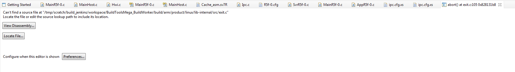

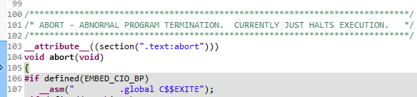

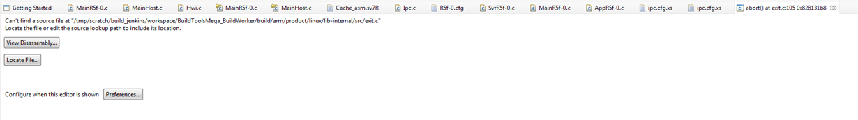

Now I can successfully upload the output binaries to the A53 and R5F_0 cores and the cores halts at the main() functions. However, when attempting to upload the output binaries onto the R5F_1 core, the core immediate goes into the "Suspended" state after the binaries have been uploaded, with some xdc error functions running:
A cant find source error is also displayed:
What can be the cause of this error? I have not yet rebuilt the IPC examples, thus the output binaries came standard with the IPC component installation. I believe the error may be with incorrect board initialization and setup? Otherwise it might be incompatible versions of XDCtools/PDK/IPC etc. Could anyone please assist? Unfortunately there is only reference for uploading this example on the AM537X IDK, which I have referred to.

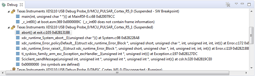

  • Hi Sahin,
    Found the linkage error in my CCS project. My project was setup as debug version, however it appears as if it should be set to the release version. It can now upload onto the R5_0 core successfully.
    However, I am still unsuccessful with uploading the binaries on the R5_1 core. The output goes straight to the abort() function after uploading it onto the core:
    This is why I believe there is an error with my EVM initialization, seeing that both the prebuild binaries and my CCS build output cannot execute successfully on R5_1

  • Hi Johnny,
    Just wanted to give you a quick update - I was able to reproduce this issue on my board. I'm currently working on getting workaround/fix for you and should have an update for you soon. I appreciate your patience.
    Sahin
  • Johnny,
    You will need to add the function "Change_MCUSS_to_SplitMode" to launch.js so that the R5Fs can be changed to split mode before loading the DMSC firmware and connecting to R5F-0. Please see the code snippet of launch.js with this fix below.
