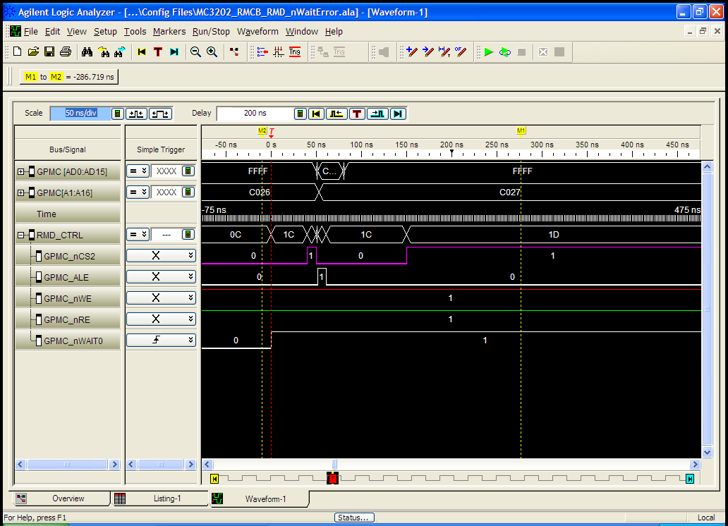

Below the representation of the error image:

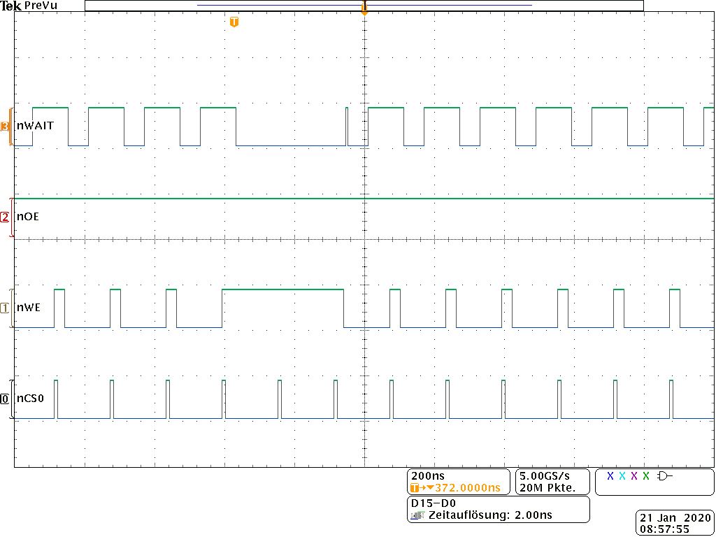

Following is the analog measurement of the write_enable signal, the signal is not pulled low by the GPMC controller:
A review of the timing both before the situation and in case of error shows no manipulation of
GPMC timing what this could have been explained.

    I see CS and ALE have gone low like the beginning of all the previous GPMC cycles, but WEn did not go low as before. Why would that happen?
    Can you provide a register dump of all the GPMC Registers from the CCS register window? A dump before the issue occurs and after would be most helpful.
    Since WAITn still became asserted low, the GPMC state machine might be frozen until WAIT is released. For debugging can you force WAITn high just to see if the GPMC resumes after WAIT is released?
    The real question is why didn't WEn go low before the WAIT signal, as it should have?
    Is it possible the GPMC is performing a read instead of a write at the time you have circled? You could easily test this by probing the OEn signal as well as the WEn signal (making sure that OEn is pinmuxed correctly and validly programmed in the GPMC registers). It should go low instead of WEn if a read has been issued to the GPMC.
    What is the repeatability of this behavior? Does it correlate with any other event? Does it happen at the same address? Does it occur at the end of the loop? Could there be any other interrupt in this applicaion? Did you try using DMA?
    Is any other part of the program changing pin mux? Can you check pinmux registers after the issue occurs and compare them to before the issue occurred? Are any error bits set in GPMC_ERR_TYPE or GPMC_ERR_ADDRESS?

    we cant see any differences before and after the issue.
    yes, and also the rest of the soc. also the access via a hardware debugger is impossible in issue state. Only an external reset on the external device (fpga) helps to get rid of the blocked state.
    here are the state of gpmc-pins after resetting the external device:
    the "gpmc_oen_ren"-Pin is already traced in the first picture of this thread. Please look at the first picture (also available in the above picture), there it is called GPMC_nRE (green wave-line)
    the behavior is very well repeatable. we played with the GPMC_TIMEOUT_CONTROL register. the benefit of this register is, that the last access-address is latched in the GPMC_ERR_*-Registers. there we see that it is always the same address on the external memory.
    yes we have checked both. No changes before/after issue in pinmux and no hints in GPMC_ERR_* regs except the case when using GPMC_TIMEOUT_CONTROL register.
    Mark Mckeown said:
    How have you programmed MMU and cache?
    we use linux and map the memory to the user-space through the uio-framework. A look in the source-code shows that the memory is mapped as strongly-ordered memory.
    any other hints? what about the note in the first post when the ARM-DSB (Data Synchronization Barrier) command is used. Does this indicate any missconfiguration for example?
    thank you for the support.

  • It's a long shot, but please validate the configuration of the register conf_gpmc_wen at physical address 0x44E10898 in the case where you have the issue.
  • Thanks Oleg,
    We'll review your MMU/cache settings.
    What address is in the GPMC_ERR_ADDRESS register after the timeout? I think it could be a clue.
    If you write to this address first or by itself, does the WEn stay high instead of going low?
    Mark
  • Hi Oleg, Dirk,
    I have unlocked the thread. Please try to post your reply now.
    Mark
  • Hi Brad,
    thanks for the hint but we already did this. The config is still correct in case of the issue. See my next post that shows the accesses after the issue..
  • Hi Mark,
    Could you and maybe somebody from your os-team see any missconfiguration from our side?
    It's an address in the mapped fpga-memory. We wrote a simple application were we write different randomized patterns to the memory location and some others. But we did not see the issue and the WEn signal behaves correct in this case. It happens only when we start our main application with the code that we are posted here. But that is also what we are doing in our simple application.
    Currently we configured slower timings to disable the wait-monitoring and to see what happens after the issue. The WAIT signal is still driven by the fpga. The wave-form show that the chip-select signal is driven many times without a corresponding WEn signal. That matches with the issue that you are pointing us already here. The recommendation there is to use strongly-ordered oder device mapping to the gpmc memory location. We checked the mapping and the uio mmap function and there we have strongly ordered configured.
    So the question is: how is it possible that we get "speculative accesses to the memory" even tough we have strongly-ordered mapping on this location?
    Oleg
    Strongly ordered memory will not result in any speculative accesses.  However, you might be assuming that only a single mapping to this physical address range exists in your system.  If there is another virtual address mapping elsewhere in the system (normal memory rather than strongly ordered), this could still result in speculative accesses.
    Are you able to see the corresponding GPMC address on the pins in the case where you see the chip select assert but not nWE or nOE?
  • Hi Brad,
    Thanks for the explanation. We already checked this when we read about "Mismatched Memory Attributes" in the ARM Architecture Reference Manual (A3-139) yesterday. We have a linux kernel driver that also maps the memory of the fpga with the ioremap_nocache() function. And this results in a device-only mmu mapping, different to the strongly-ordered mapping from userspace through the uio framework. We compiled the driver out of the kernel but the issue still remains.
    I will check this tomorrow morning (germany) and post the result here.
  • Hi Brad,
    Oleg Karfich said:
    Brad Griffis
    are the logic analyzer pics in the first post sufficient for your question? Signals GPMC[A1:A16]
    Another question regarding the "speculative accesses" and "mismatched memory attributes". If we had this, shouldn't the pins nWE or nOE asserted anyway?
    Oleg
    Yes and no.  I was re-reading the thread and trying to understand the issue a bit better.  In fact, I'm wondering if maybe there are two slightly different manifestations of the issue:
    1. Your original screenshot looks like you were doing a bunch of sequential accesses and then suddenly things stopped.  However, there were a lot of questions surrounding the nWAIT signal and whether it was the "real" issue there.  Was there a conclusion on that topic, e.g. does that issue disappear if you disable the "WAIT" functionality in the GPMC?
    2. There's the behavior similar to the other thread where you might see the chip select assert when you're not even attempting to access the GPMC.  Do you see that happening, or do you only see issues within the context of accesses that you're deliberately performing?
    In the case of speculative accesses, I've seen many cases of "phantom accesses" like the other thread mentioned.  It is consistent that the nOE/nWE signals are not asserted in those cases.
  • Hi Brad,
    Brad Griffis said:
    1. Your original screenshot looks like you were doing a bunch of sequential accesses and then suddenly things stopped.  However, there were a lot of questions surrounding the nWAIT signal and whether it was the"real" issue there.  Was there a conclusion on that topic, e.g. does that issue disappear if you disable the "WAIT" functionality in the GPMC?
    No, the issue still remains if the WAIT functionality is disabled. We described the behaviour in [1] and showed this with a wave form. So the WAIT functionality is not the problem here.
    Yes, we see the issue only when we start our application and try to access the memory within a loop, described here [2].
    Meanwhile we reduced the problem to some neon instructions that are generated by our compiler. Amongst other compiler flags, we build our application with "-ftree-vectorize". This permits the compiler to vectorize the loop that is mentioned in [2]. The vectorization ends up in NEON load (vld1.32) and store (vst1.32) operations. If we disable this vectorization by removing the compiler-flag or when we compile with "Os" the issue disappears. Even the "dsb" instruction we mentioned to fix the problem, also only disabled the neon instruction and therefore doesn't seem to be any related.
    We are using "arm-linux-gnueabihf-gcc (Linaro GCC 5.5-2017.10) 5.5.0".
    Does the gpmc-controller on the am335x soc have problems with this kind of neon instructions?
    Thanks for your response.
    Oleg
    [1] https://e2e.ti.com/support/processors/f/791/p/859983/3236399#3236399
    [2] https://e2e.ti.com/support/processors/f/791/p/859983/3180379#3180379
  • Hi Oleg,
    I apologize that this thread has not found resolution yet.
    I have enlisted the help of another colleague to help to drive it to closure.
    Please help us to take a fresh look at the issue by first restating the facts.
    Can you confirm the following statements and answer the questions below?
    * The problem is that the WEn signal fails to assert low during one of the write cycles to GPMC CS0
    * This problem occurs with and without the WAIT signal asserted
    * It is repeatable and occurs when writing to the same word each time
    Does the problem occur during CPU loops like the code shown or during DMA accesses (or both)?
    If CPU loop, the problem stops happening if you insert a DSB instruction? Where is the instruction? Inside the loop?
    If DMA, can you share the DMA configuration? DSB cannot be used during a DMA burst
    Its not clear to me how ARM NEON is related.
    If you disable ARM NEON, does the problem stop happening?
    Are you utilizing the SIMD execution of the NEON? Is it required?
    Have you attempted to use the GCC compiler instead of Linaro? TI does not use this compiler for the ARM Cortex-A8.
    The strongly ordered configuration is the right one to use. Confirm strongly ordered is chosen for the GPMC data space.
    Can you please provide assembly code from when the problem occurs verses when the problem does not occur? (showing the NEON instructions)?
    Thanks.
    Mark
