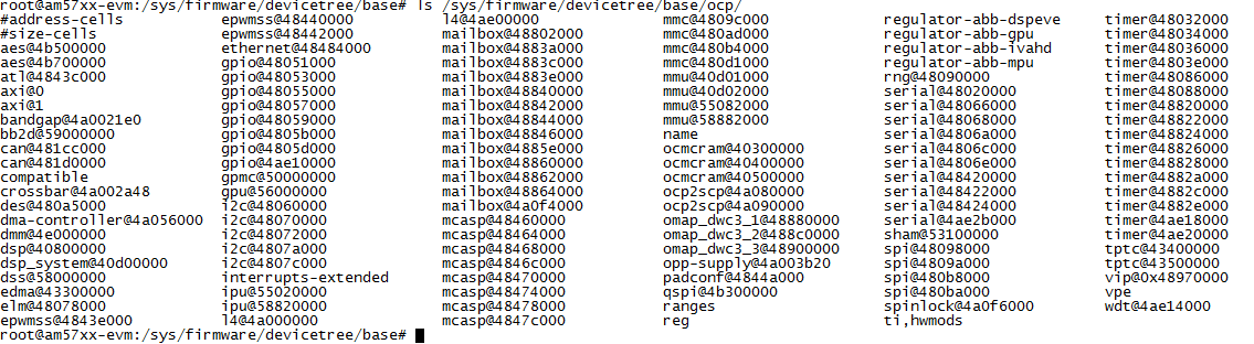

  • i modify the resource table file,    PRUICSS_create is OK,
    but when linux booting, there are many error message.
    [ 9.168177] virtio_rpmsg_bus virtio2: rpmsg host is online
    [ 9.173732] ------------[ cut here ]------------
    [ 9.173746] WARNING: CPU: 0 PID: 74 at drivers/bus/omap_l3_noc.c:147 l3_interrupt_handler+0x24c/0x350
    [ 9.173751] 44000000.ocp:L3 Standard Error: MASTER DSP1_MDMA TARGET PRUSS2 (Read Link): At Address: 0x00026000 : Data Access in User mode during Functional access
