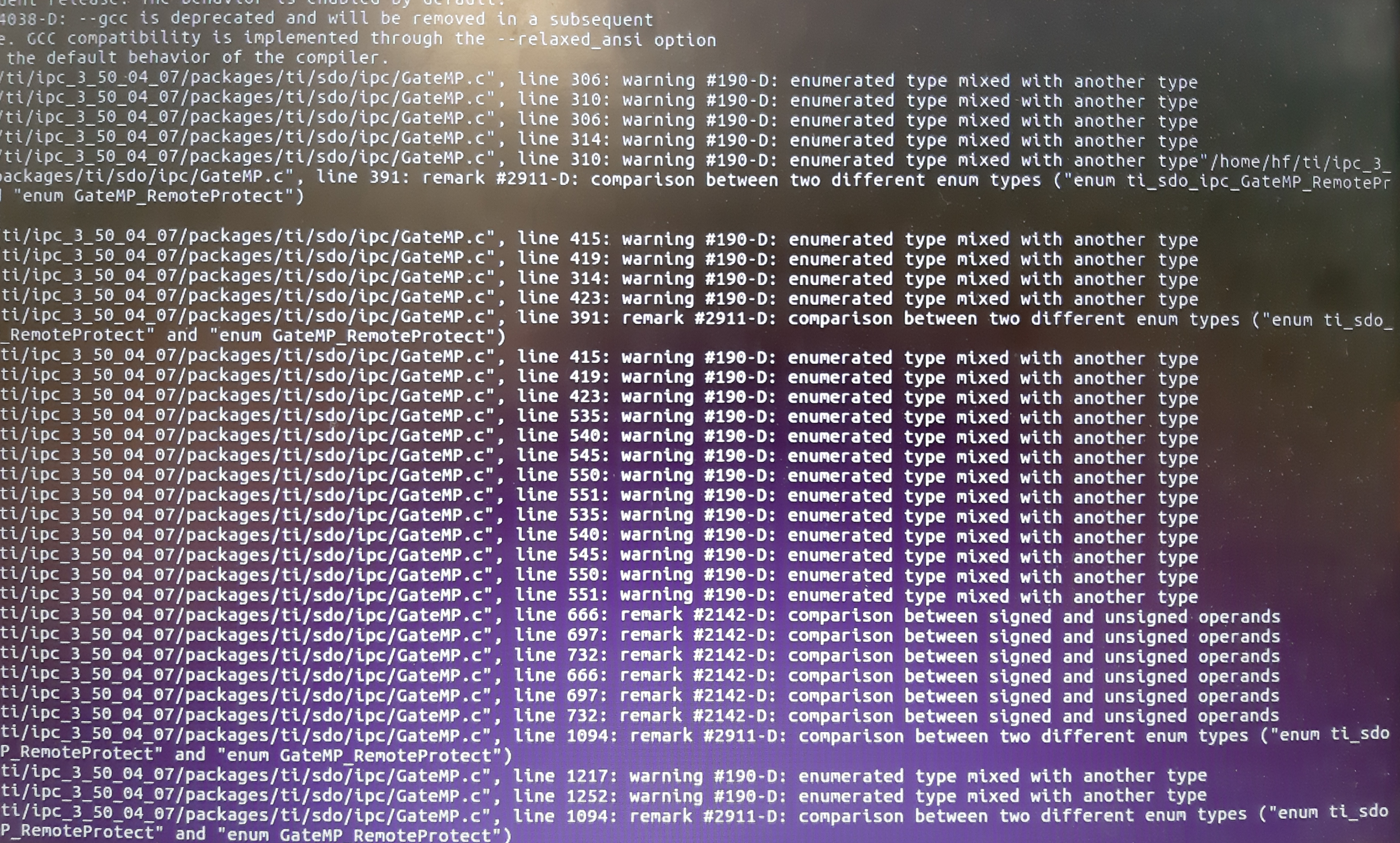

    I used the top-level makefile to build x02_messageq example but it generated following warnings:
    Would you please help me?
    Those warnings are expected and can be ignored. Once the build is complete, you can find the binaries under ~/ipc_x_xx_xx_xx/examples/OMAPL138_linux_elf/ inside the bin folders.
