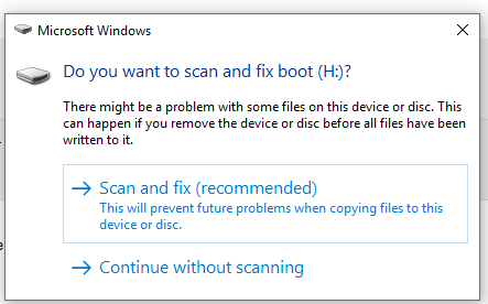

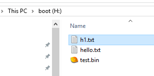

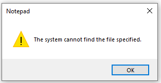

    Next I eject the SD card and insert into a Windows PC.  Windows Explorer correctly lists h1.txt for SD card file contents and h1.txt properties displays correct size of 3 bytes.  However, I get "can't find file" anomaly when trying to open h1.txt.  If I then eject and reinsert the SD card then Windows wants to repair it.  See screenshots below.
    Note, I added "printf's" to verify f_close() is being performed correctly for the "cat" command.  FYI - per your advice FATFS_close() also didn't help.
    Please let me know if you have any ideas to fix this anomaly.
    Dave
  • FYI - file "h1.txt" is no longer present after the "scan and fix" operation.
