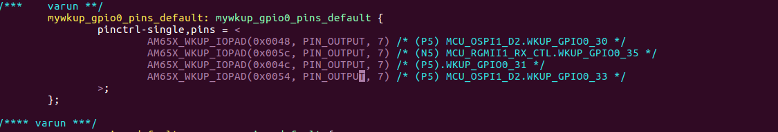

  • Hi Povel,
    Yes we added already in that dtsi file.But still when we write that value into address in shell only we are able to toggle the GPIO.
    please have a look:
    please have a look:
    Should be input/output, not output only.
    - AM65X_WKUP_IOPAD(0x0048, PIN_OUTPUT, 7) /* (P5) WKUP_GPIO0_30 */
    + AM65X_WKUP_IOPAD(0x0048, PIN_INPUT, 7) /* (P5) WKUP_GPIO0_30 */

    We have to write these values in  board/ti/am65x/evm.c ? or any other file?
  • Hi Varun,
    The idea in my previous post was to configure in kernel or uboot only pinmux register 0x4301c048, while GPIO module registers (GPIO_DIRx, GPIO_SET_DATAx, etc) to be configured in user space through sysfs.
    If you need to configure GPIO module registers in uboot, then you can do this in
    1. u-boot/board/ti/am65x/evm.c
    or
    2. u-boot/arch/arm/mach-k3/am6_init.c
    Pavel
