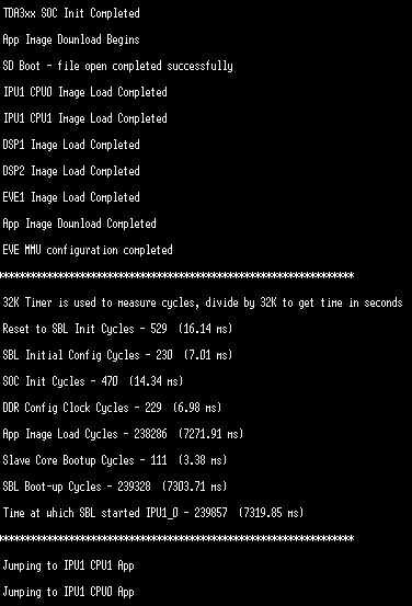

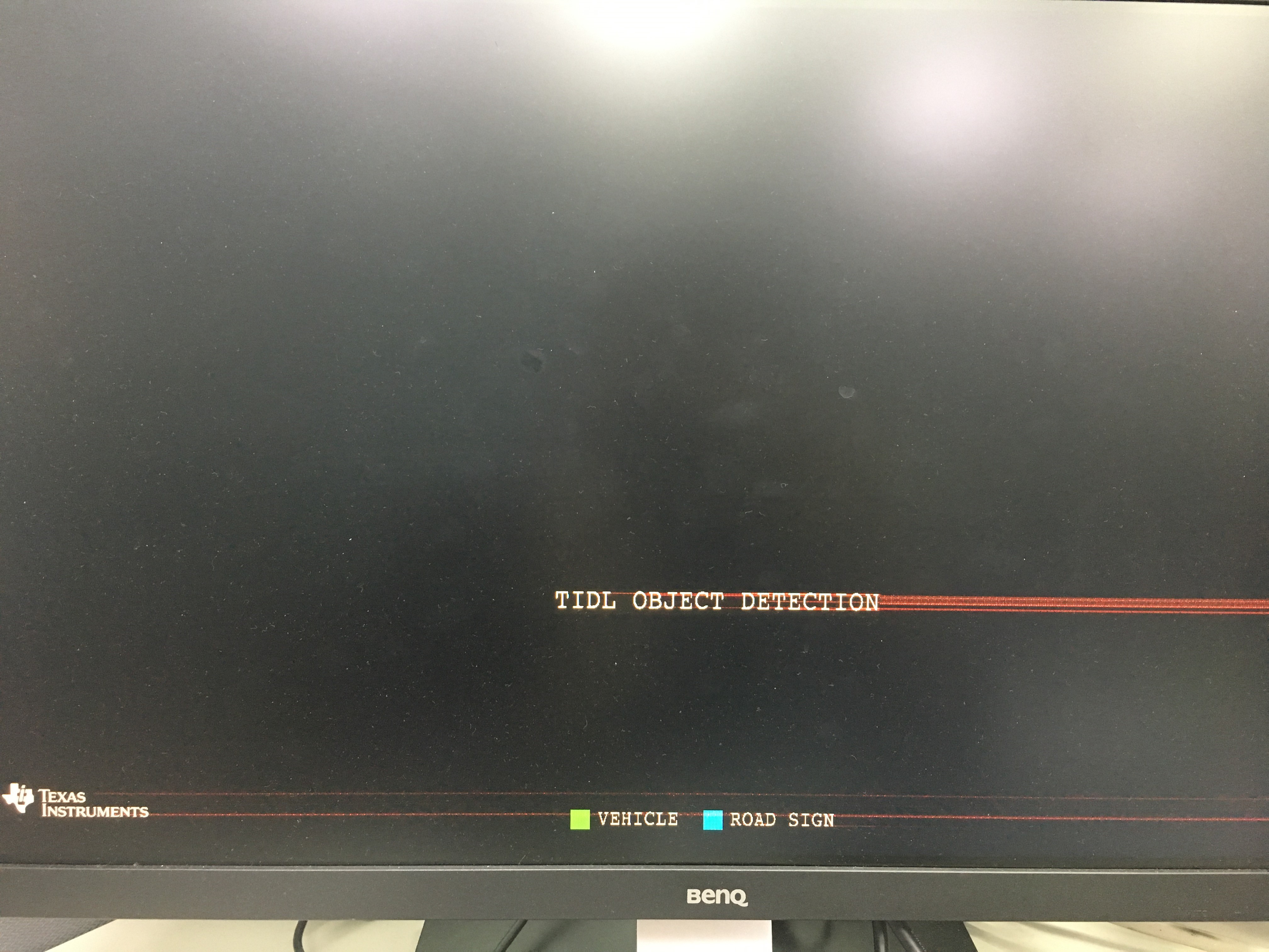

I'm working on migrating TDA2 TIDL_OD to TDA3.
When running TDA3, I got an error:
[IPU1-0]     19.150948 s:  SYSTEM: ERROR: No link registered at link ID [86] !!!
[IPU1-0]     19.151040 s:  Assertion @ Line: 296 in C:/PROCESSOR_SDK_VISION_03_0   7_00_00/vision_sdk/apps/src/rtos/usecases/tidl_OD/chains_tidlOD_priv.c: status =   = SYSTEM_LINK_STATUS_SOK : failed !!!
 TDA3xx SBL Boot
 Identified 15X15 Silicon
 DPLL Configuration Completed
 Clock Domain Configuration Completed
 Module Enable Configuration Completed
 TI EVM PAD Configuration Completed
 DDR Configuration Completed
 TDA3xx SOC Init Completed
 App Image Download Begins
 SD Boot - file open completed successfully
 IPU1 CPU0 Image Load Completed
 IPU1 CPU1 Image Load Completed
 DSP1 Image Load Completed
 DSP2 Image Load Completed
 EVE1 Image Load Completed
 App Image Download Completed
 EVE MMU configuration completed
 32K Timer is used to measure cycles, divide by 32K to get time in seconds
 Reset to SBL Init Cycles - 529  (16.14 ms)
 SBL Initial Config Cycles - 230  (7.01 ms)
 SOC Init Cycles - 468  (14.28 ms)
 DDR Config Clock Cycles - 229  (6.98 ms)
 App Image Load Cycles - 238772  (7286.74 ms)
 Slave Core Bootup Cycles - 112  (3.41 ms)
 SBL Boot-up Cycles - 239813  (7318.51 ms)
 Time at which SBL started IPU1_0 - 240342  (7334.65 ms)
 Jumping to IPU1 CPU1 App
 Jumping to IPU1 CPU0 App

  • Hi Anuj,
    To skip decode link, I regenerated tidlOD usecase by removing "NullSource -> Decode -> VPE -> Dup" to "NullSource -> Dup" in chains_tidlOD.txt.
    And I also edited EVE1 ocmc address to ocmc_1.
    But when I ran on TDA3, the log stoped at "Jumping to IPU1 CPU0 App".
    Please find attachment is my regenerated usecase.
    https://e2e.ti.com/cfs-file/__key/communityserver-discussions-components-files/791/tidl_5F00_OD.7z
    How to resolve this problem?
    Thank you,
    Gary

  • Hi Anuj,
    After I added the "pChInfo->flags" and some nullSource link related codes (refer to null_src_display uscase) in tidlOD_SetAppPrms(), I can enter the TIDLOD Menu without errors.
    But when I checked the display result, it only showed TIDL text on screen, no video screen & detected results.
    Please find attached for the reference.
    I also checked the statistic results, I found:
    1. Cores dropped too many frames
         a) The nullSrc link received 30fps, but it dropped 26.6fps. So there were only 3.6 fps output.
         b) ALG_TIDLPREPROC  link dropped another 2.7 frames,
         c) SYNC_0  dropped all the rest frames, so there were no frames output.
    Is it the reason why there did not show video screen?
    How can I fix this? Please advise me, thank you.
    I also attach usecase link map and log, hope they can be helped.tidl_OD.rar
    Gary

    I used a clean tidl_OD use case and regenerated it without using VPE and vcodec.
    Then I modified below for nullSrc input
    pChInfo->flags = System_Link_Ch_Info_Set_Flag_Data_Format(pChInfo->flags, SYSTEM_DF_YUV420SP_UV);
    pChInfo->flags = System_Link_Ch_Info_Set_Flag_Buf_Type(pChInfo->flags, SYSTEM_BUFFER_TYPE_VIDEO_FRAME);
    I used the model located in "VSDK3.7\apps\tools\TIDL_files\" to test.
    Gary
  • Hi Gary,
    Sorry, I missed that. SYSTEM_DF_YUV420P is not supported. Please use SYSTEM_DF_YUV420SP_UV (YUV 420 Semi-Planar - Y separate, UV interleaved). You have to create input video in the same format.
    I don't have video stream to share at the moment.
    In the example, the input data is not read from file but it is already in DDR so it is much faster.
    Stanley
  • Hi Stanley,
    Now I can show the video on TDA3 correctly, thank you.
    But the fps is quite low, it's only 2.3 in OPP_HIGH mode.
