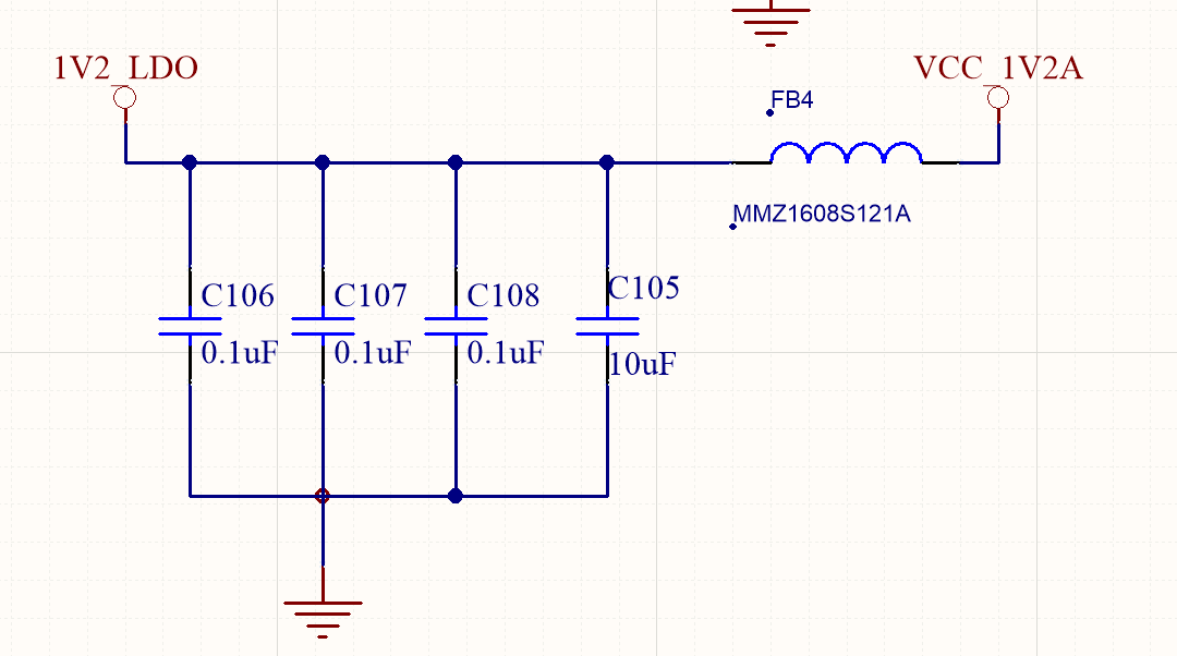

I make my own designed C6748 board.
The program is boot from eMMC.
I made 20 boards, 18 of them can boot normally from eMMC and run the program normally when power on.
But 2 of them cannot boot and run normally when power on, but the 2 boards can boot and run normally when I press the reset button.
The schematic of the board is shown below. The VCC_3318 is 1.8V and the RC takes about 200ms.
I monitored the reset signal and compare the 2 boards with the other 18 boards, the reset signal waveform is just the same.
Question: Is it not accpetable for the C6748 to be reset using a RC reset circuit, since the signal changes too slow? I needs a steep changing signal?
Thank you.
Frank
    Just this bit of your schematic does not give much information. Need to see the connection to the SoC. Also may be the power supplies circuit.

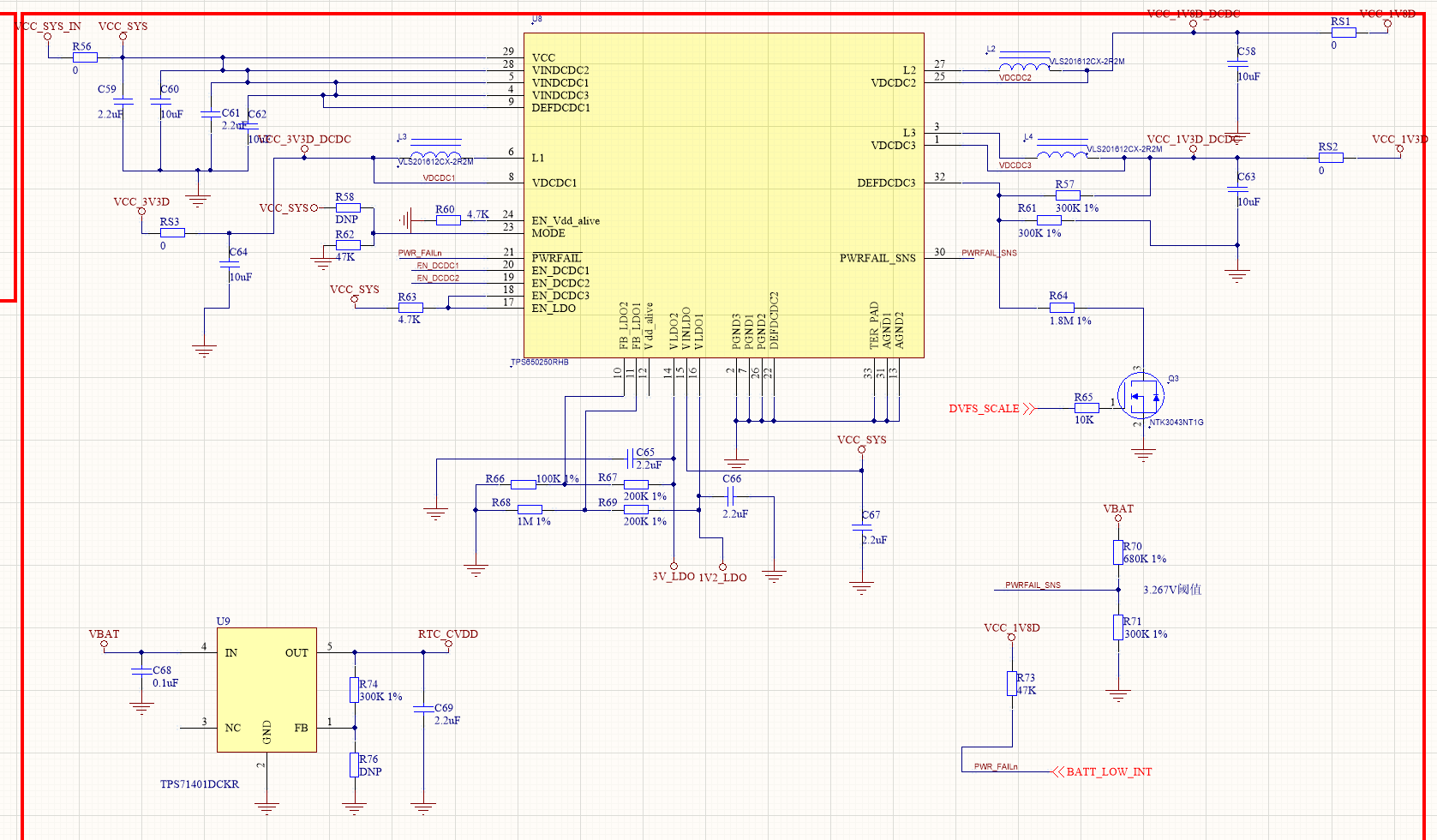

           Before I replace the TPS3831E16 chip , the schematic is below:
         (VCC_3318 is 1.8V)
        After I replace the TPS3831E16 chip , only the RC reset circuit is replaced by the schematic below:
        But, the problem still occurs.

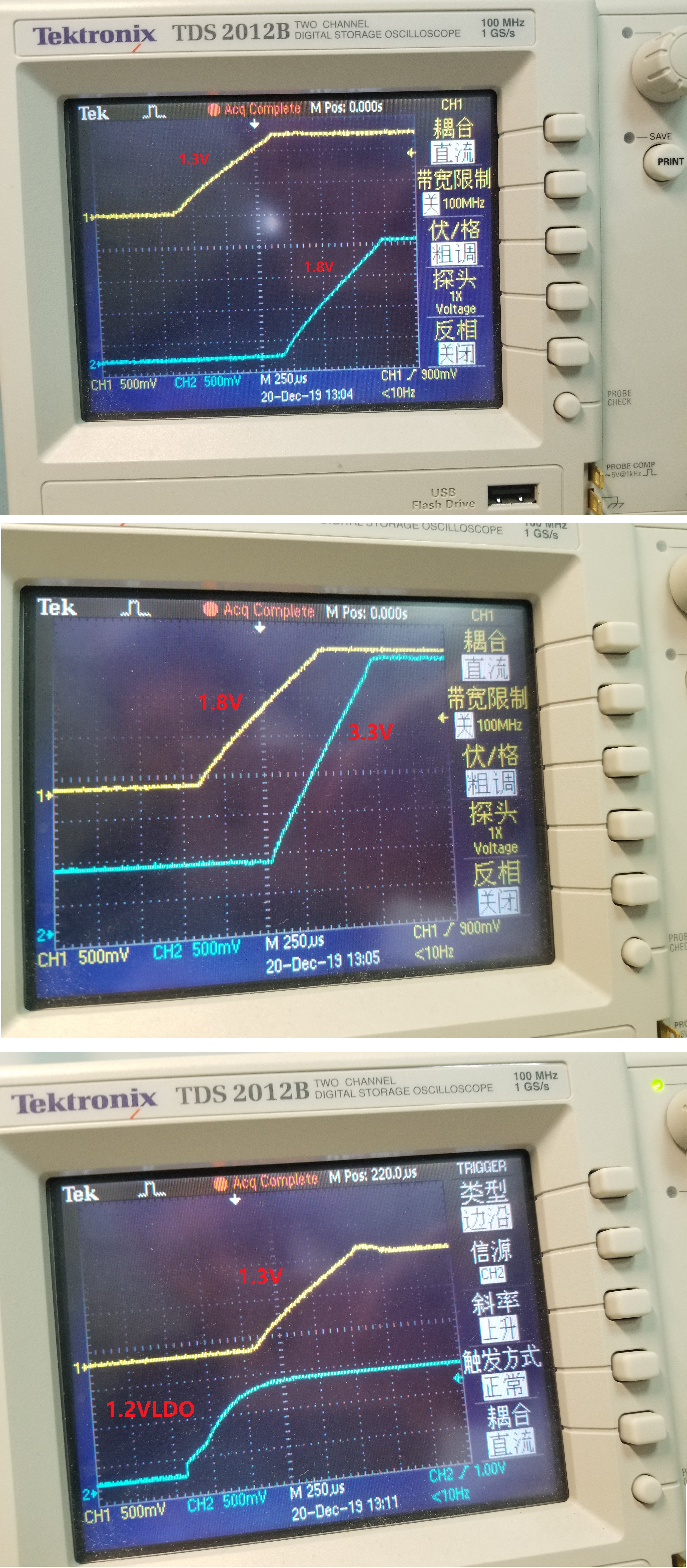

        3. I monitored the power up sequence with oscilloscope, I'm sure the sequence is right.
            1.2V  then    1.3V   then    1.8V   then    3.3V  according to the schematic.

  • Hi Frank,
    Can you provide a scope shot showing the timing of RESET in the case where the 2 boards fail to boot?

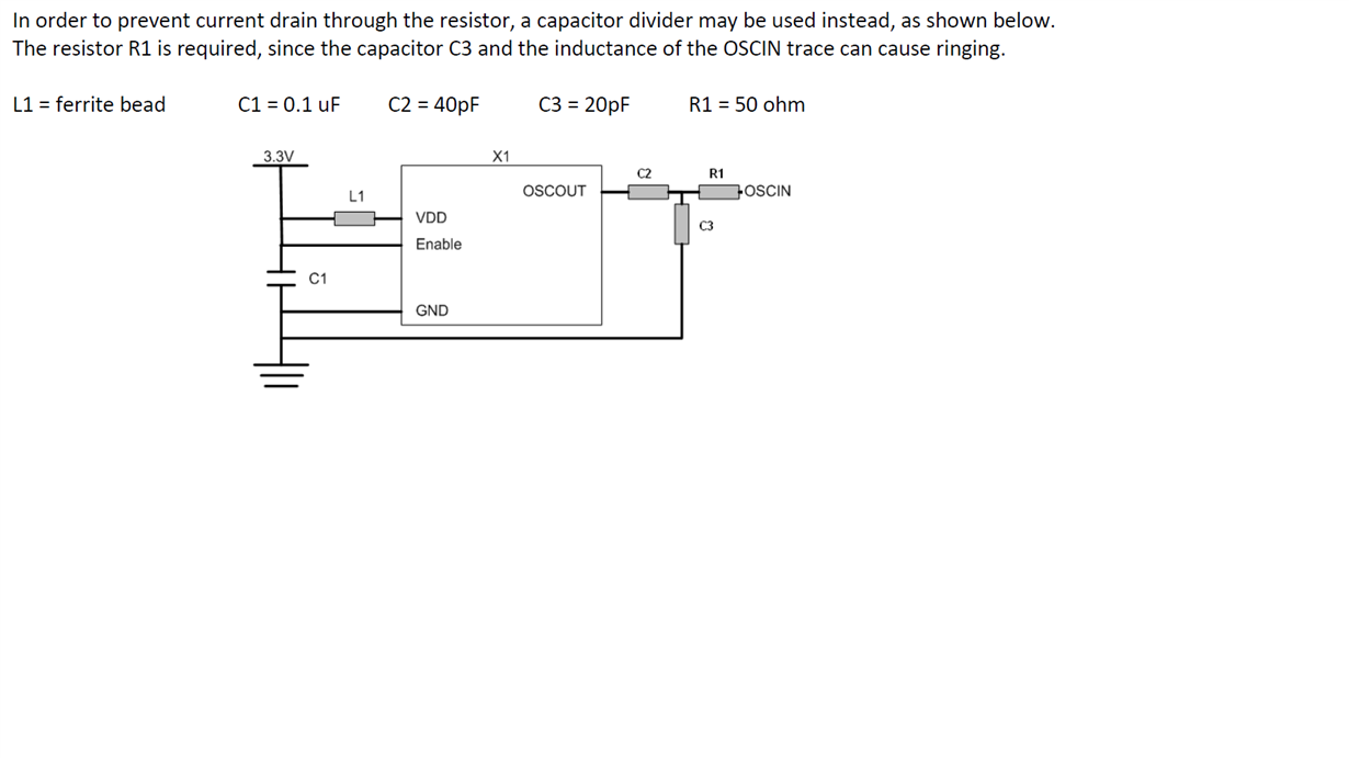

         1、According to the Errata Usage Note 2.1.4 System-Level ESD Immunity Usage Note, " If ESD robustness is a concern, it is strongly recommended to avoid using the internal oscillator as a clock source. An external 3.3V clock source with a resistor voltage divider as in Figure 2 can be used to
    externally generate the required 1.2V input clock."
              But in my system, I have to use the internal oscillator. Because using external 3.3V clock source with a resistor voltage divider, the resistors must be small (for example, 165 and 100 ohm). 3.3/265=12.5mA, concerning the 50% duty cycle, 6.25mA current is wasted on the resistor. My system is a battery powered system, and the 6.25mA is too much waste. But 1.2V external oscillator does not exist. And the resistor can not be large, because the input impedance of the OSCIN is low.
             Do I have better choise? To make System-Level ESD Immunity, if I have to use the internal oscillator.

    If your end product needs to go through System ESD testing , we strongly recommend using an external oscillator. Other robustness recommendations are listed in the errata but may not provide as much immunity as an external oscillator.
    If current drain is a concern, you can evaluate putting a cap divider circuit instead (we did limited testing with this, and it seemed ok too)

           Q1. Since C2 and C3 are in series connection, the totol cap from OSCOUT to GND would be Ctotal=20//40pF=13.33pF.
                  f=24MHz, then |Zc|=1/(2*pi*f*Ctotal)=497ohm, about the same level using the resistor solution. The current drain is still big. 3.3/497=6.6mA, concerning the 50% duty cycle, 3.3mA current is wasted on the caps. Is there any way to low the current drain?
           Q2. I would follow your advice.Thank you so much.
